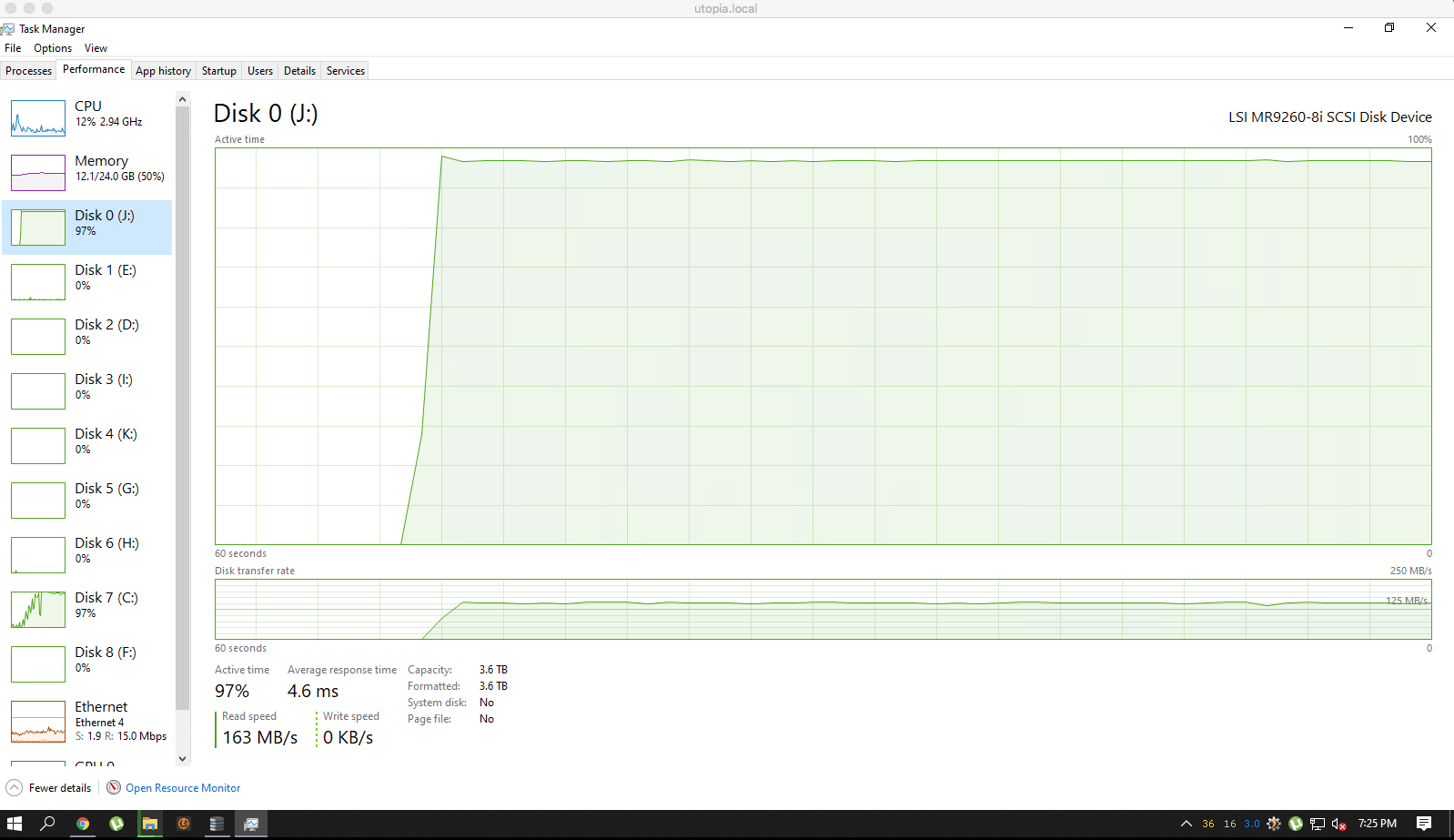

Ok so trying a few different things. If i start a file transfer FROM a drive attached to the 9260 to a drive that is NOT on the 9260 I get very consistent speeds. It seems the issue is only when transferring from one drive to another when they are both on the 9260.
Attached is a screenshot of a transfer from the striped RAID0 on the 9260 to my C: (860 EVO SSD)
