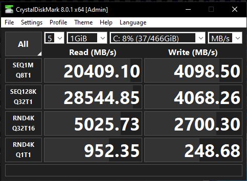

Add a small (64gb) SSD and use PrimeCache for the OS drive. You'll get insane boot up speeds. I spent money on an WD SN850 500gb M.2 drive because the Adata SX8200P wasn't running it's rated speeds. Found out Adata switched controllers in mid cycle and didn't tell consumers about the speed drop in performance. I get the SN850 and was also disappointed as it didn't reach it's rated 7k reads. Not even 6k. I could've kept using the Adata drive.
I have 2 raid-0 configs: (1 set for games drives, 1 set for media drives) off the mobo
So I installed PrimeCache and used an old 256gb SSD as the cache drive. I also have it configured as my games drive cache.
