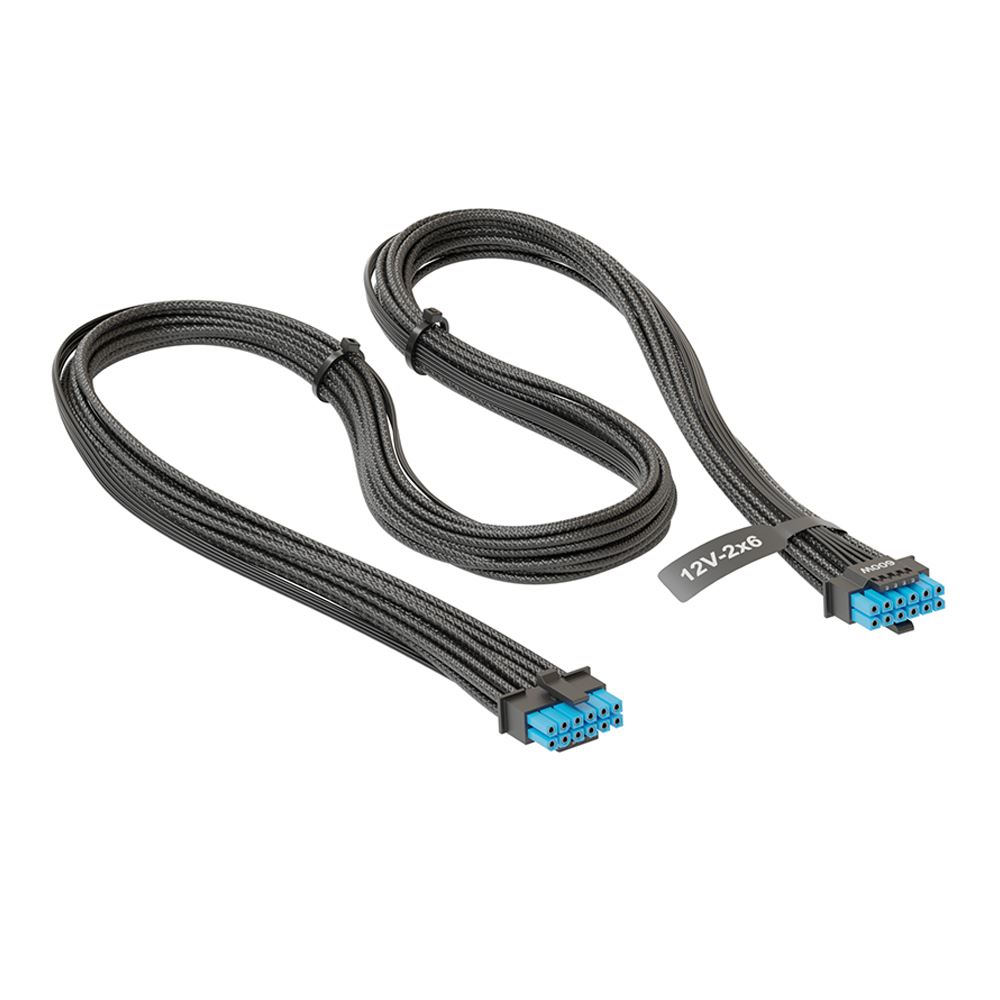

So I purchased this cable. It's an official Seasonic GPU cable. But once I brought it home, I realized my PSU is a ATX 3.0 not the new ATX 3.1 to allow this cable to work.
My only option would be to buy a brand new power supply that goes with this cable.

Seasonic says those cables will work with their ATX 3.0 PSUs. I'm assuming that Titanium 1300 is a Seasonic Prime TX-1300. https://seasonic.com/native-12v-2x6-cable/
12VHPWR and 12V-2x6 are plug compatible. 12V-2x6 sockets have longer power pins and shorter sense pins, but the cable is the same. I bought one of those too before I realized it was the same as the 12VHPWR cable that came with the PSU. Oops.
I'd just use the Seasonic cable.

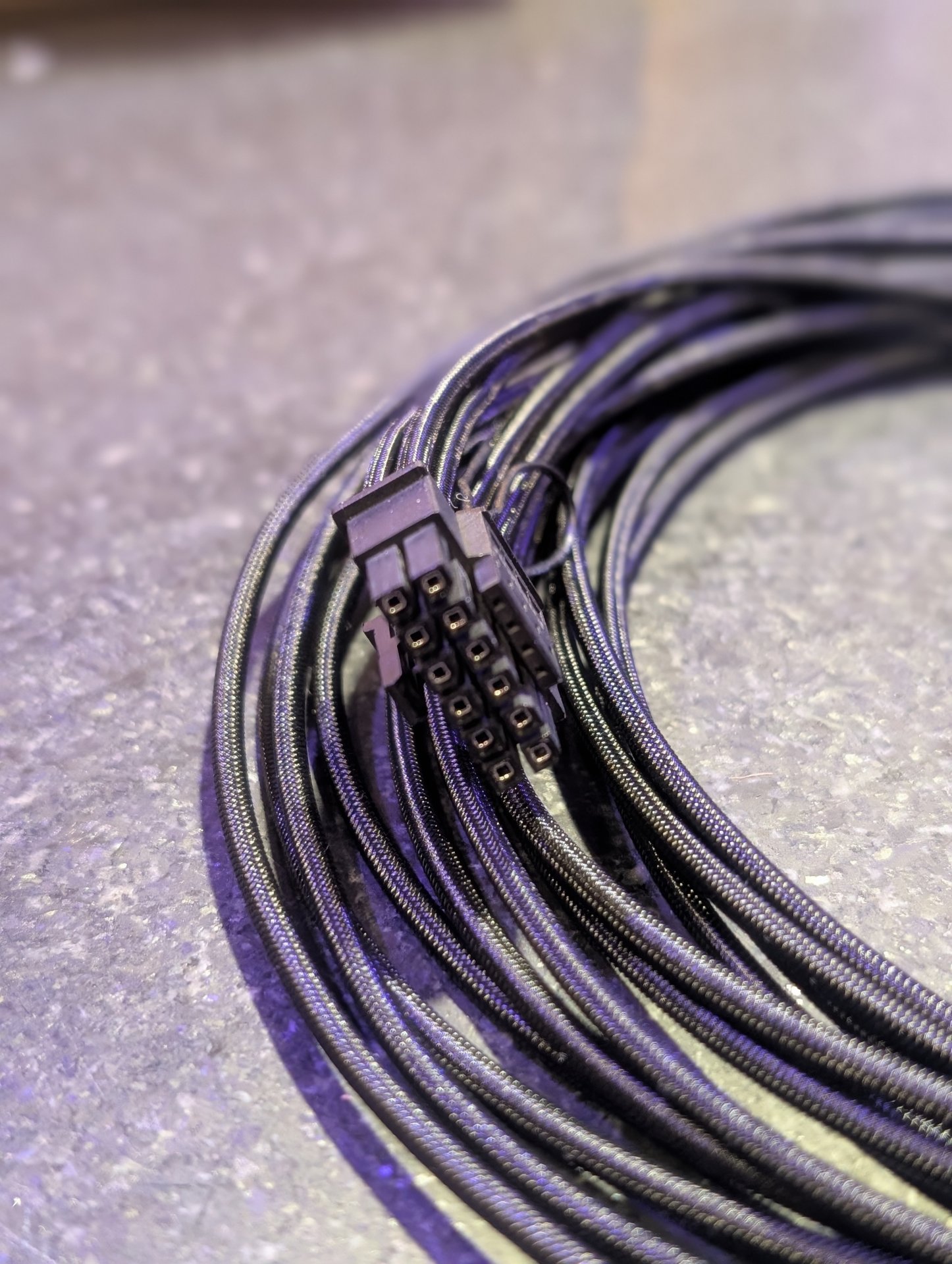

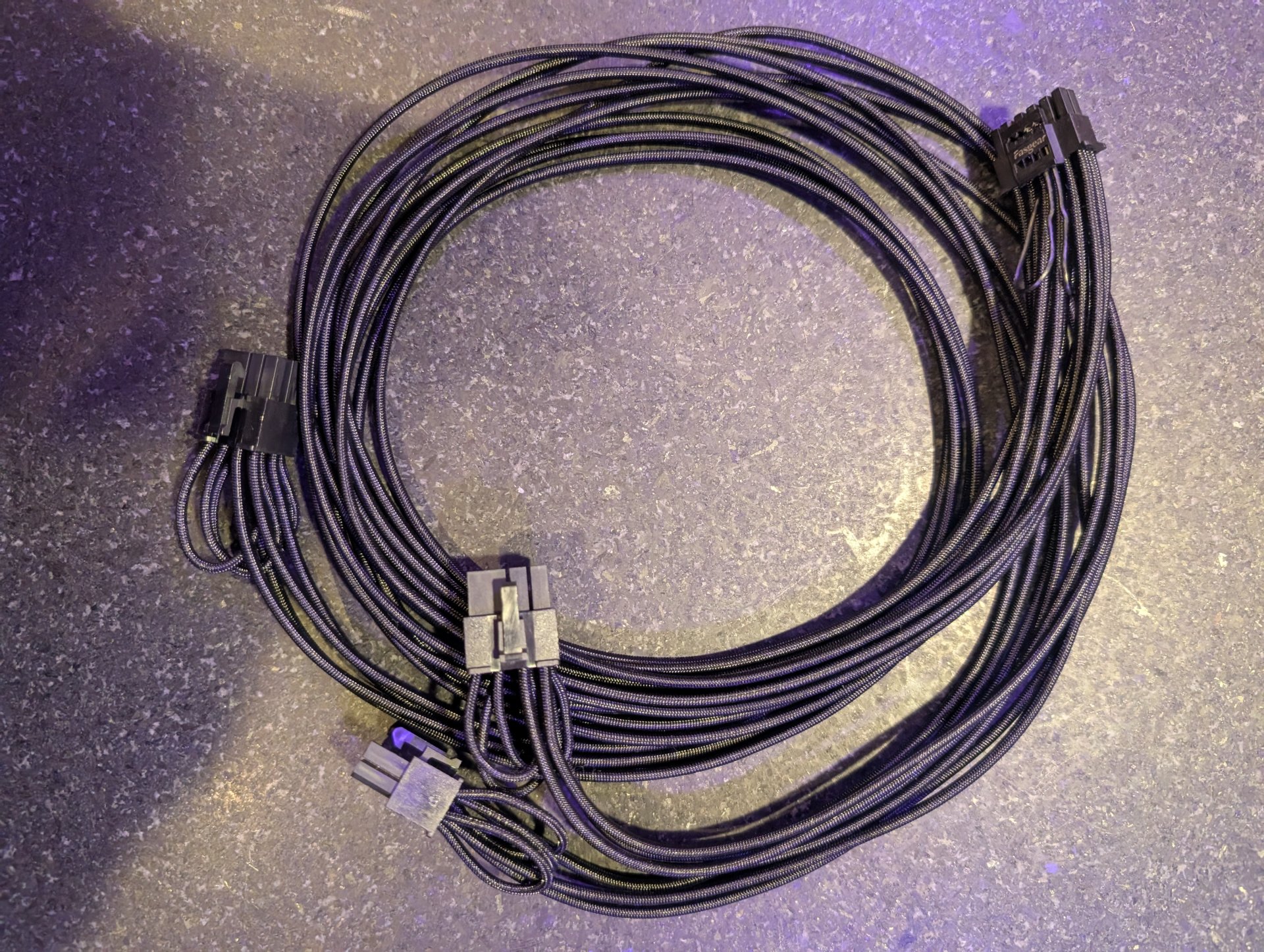

Not super impressed with the thinness of these cables and very spidery feeling like an easy to tangle mess. View attachment 719539View attachment 719540View attachment 719541
I have been using fasgear for past year and some change. It powers my 5090 and powered the 4090 before it. It was the only option available and compatible with my EVGA 1300 G2 from 2015.
If you bought the right cable you should be fine. Make sure to read the compatible PSU list. I also got one that uses 3 PCIe vs 2 just because.

I have that set, cane in a few days ago, but the thin wires scared me, I never put these on.

Please learn how to use a phone camera's focus. We are not discussing bubble wrap.
Contacted customer support, they replied quickly
" Cables look as intended and fine to me. The picture angle you sent may be deceptive. Check the wire connecting to those two pins. If you connect your GPU card and those two wire do not retract or become loose. ( They did not ) Then the connection is perfect. If those two wires are loose and can be pulled out from behind, then you have two loose wires.
Just so your aware BTOS is an official direct vendor of Seasonic cables and wires. Our cables are licensed and certified and specifically designed for Seasonic power supplies. You're cable photos you sent me look exactly like the thousands we've shipped over the last couple years. "
Best Regards "

The cable is exactly the same between ATX 3.0 and 3.1
The changes are on the PSU and Card connector end. The cable is the same.
