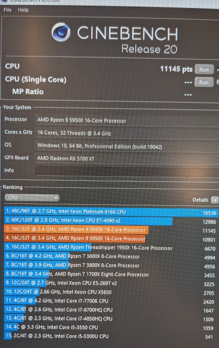

All I've done so far BIOS wise is set the RAM timings to the same as they were for my 3950x. I'm not running PBO. I'm using 64 GB as noted in my signature using the Safe Profile settings from the 1smus calculator. I've run Boost Tester to see kind of what the potential of each core is at stock and I've run CB20. Anyway, here's a screenshot of Hardware Info after a few CB20 runs.
I've seen conflicting info on line for stock CB20 scores where it seems some are low in reviews and others look like PBO was applied, that's why I'm asking. I will say that this chip seems to run 2 to 4 degrees C higher at idle than the 3950x. I may try one remount just to see if I screwed up. I am using that Der8aur Ryzen OC bracket. The CB20 scores were run with no monitoring app in the background.

Anandtech got 10,096 multi and 644 single. Seems like some decent deltas between testers.
Gonna have to remount. I hit 78 C playing Dragon Age Origins using the same settings and fan profile from my 3950x. Fans were constantly ramping up and running loud. With the 3950x, they pretty much stayed constant at low noise. I have the curve set for 40 percent at 55 degrees and 100 percent at 75 degrees.
I hope I didn't get a bad chip like one of the 3900x chips I binned. One of those ran almost 10 C hotter than the other. I remounted that cpu probably 5 or 6 times before I gave up.

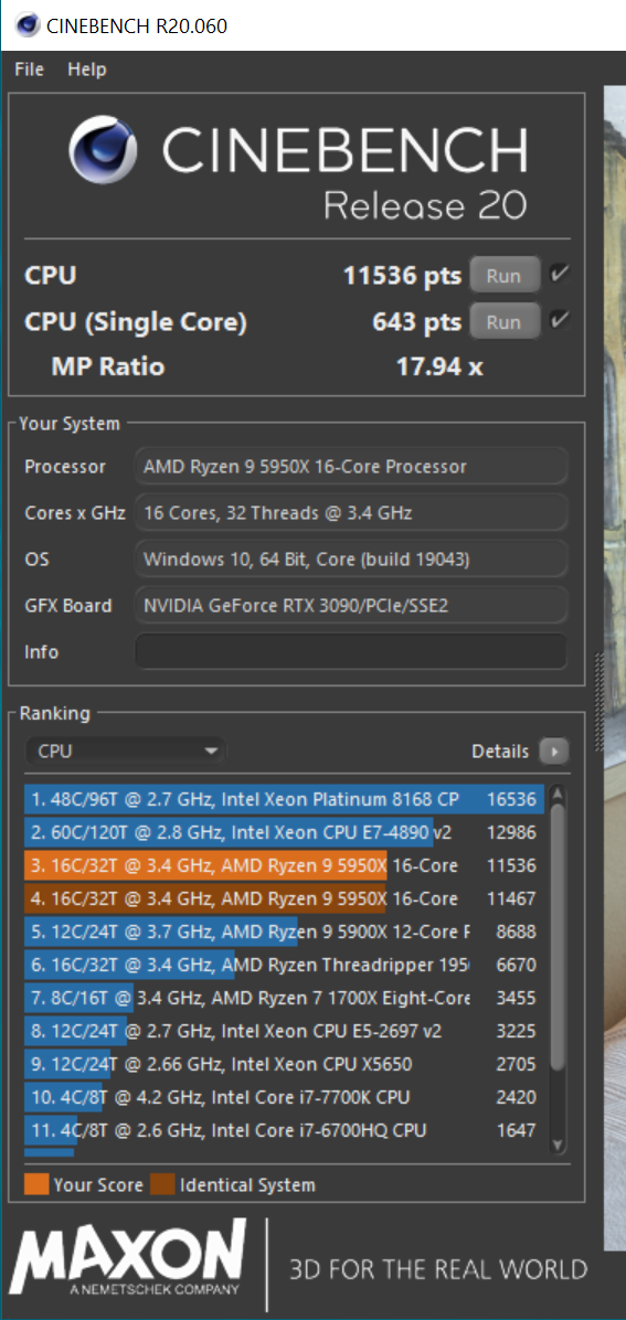

Here's a shot from my initial run with my 5950x on an Asus x570-i, Gskill 16gb 3200mhz cl14, Arctic Cooling 280mm AIO. I believe this was with PBO enabled.

I'd say yours is a keeper.

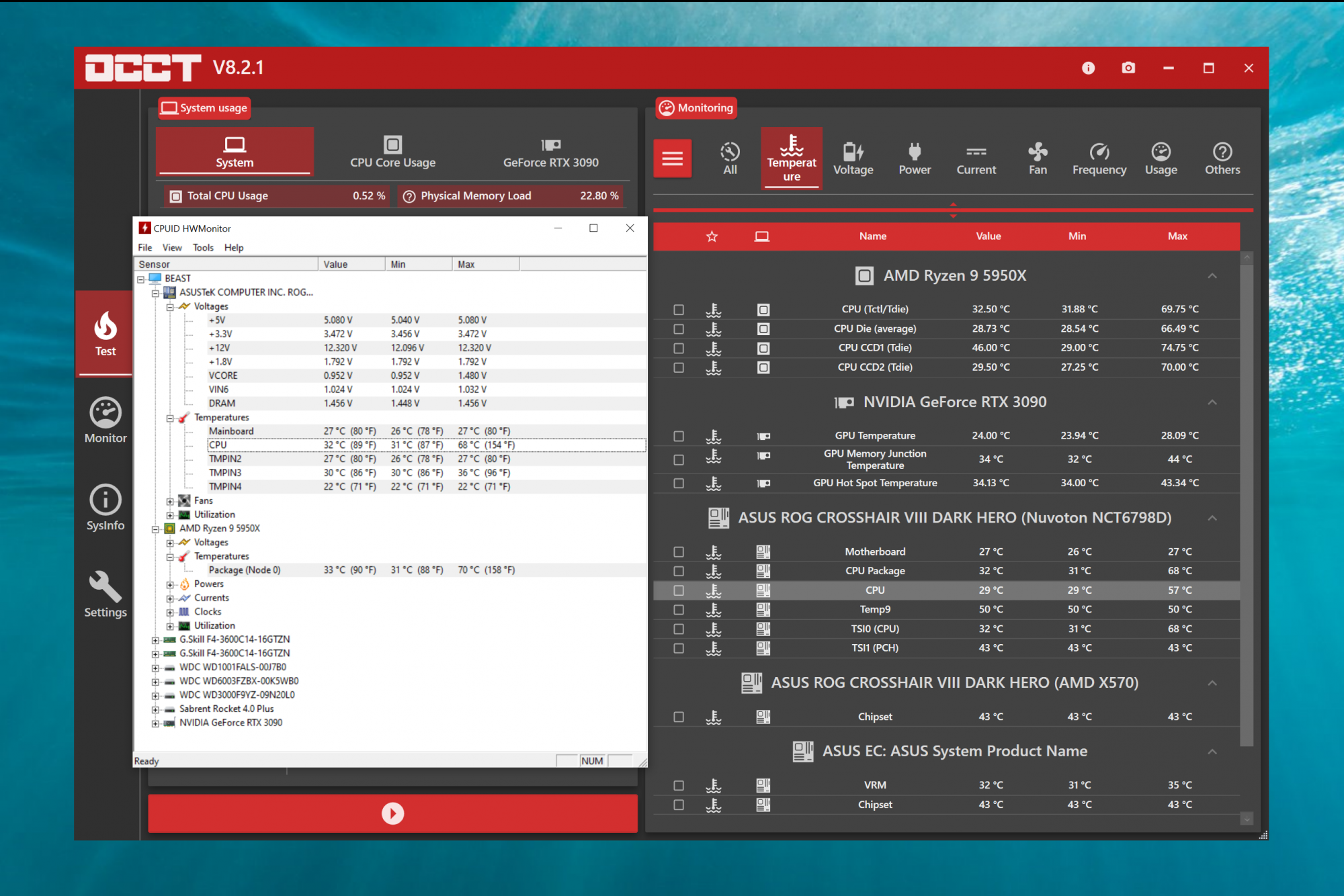

My CPU idles at 29C and I never see it get above 60C under extreme loads.
For stability testing, I'm use OCCT (ver 8.2.1). If the system can handle AVX2 on a small data set in extreme mode with a steady load for an hour without throwing a single WHEA error, then I consider it fully stable.

I thought my cooling was overkill and I idle much higher than you do. How in the world do you get that CB20 score and keep cpu at 60 and under? Which sensor are you reading?
OK, I guess it is closer to a 67-68C max. I fired up HWMonitor to have an alternate look during a bench/stress run - seems it peaks closer to 68C and idles at 32C. Still not too shabby. I think I was looking at the Dark Hero CPU temp sensor previously. Probably should be using the CPU Die (average) from the 5950x that's in OCCT instead for a more precise read of CPU temp.
