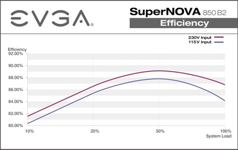

I prefer to look up the power efficiency curve of the power supply I'm looking at buying vs the actual draw of the system I'm using with it.
For example, my current system draws around 350w at load. I used an EVGA 850 B2 Gold PSU that is around 85% efficient at this range.
You should figure out the power draw of your setup and then find the efficiency curve for the supplies you're considering, and try to match the max efficiency to the actual power draw.
Here's an example of what the chart for mine looks like.
You'll see that the efficiency curve starts topping out around the 450-500w range.
Every PSU is different, so just saying "your system only draws 300w at full load, so you only need a 400w" is just wrong.
