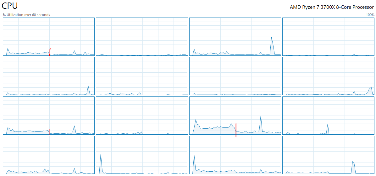

Also consider your cpu use while doing fast transfers will rocket unless you use a decent hardware raid controller.

"rocket" is a bit hyperbolic. Just as a test, I started copying a big file (80 GB) from my NVMe SSD to my RAID0 of SATA SSDs. Here is what my CPU graph looked like at the time. The red line represents when I cancelled the transfer. The copy was non-negligible in terms of CPU use, but calling it a "rocket" is way overestimating the impact.

LOL. 8-core, 16-thread. But I take your point. That said, that's why I showed the individual logical cores - none of them in particular are loaded down during the transfer. I had the same setup on my 6700k and it was also just fine :) The 'math' for RAID 0 (and RAID 1) is super simple; if I was doing RAID 5 or 6 in software then you might expect some CPU-based performance limitations or system impact.
