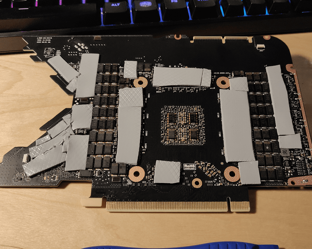

I'm going to try modding the thermal pads under the backplate as soon as I can get them shipped to me.
Ripped from oc.net. If that doesn't work, I might add some mini heatsinks to the backplate with another fan.
Be aware that adding extra pads where there weren't any before will help pull heat off the board, but will make the backplate hotter and therefore the ram will actually run hotter. Of course, if you use higher quality pads, it will probably still be better than stock.
I ordered the Thermalright Odyssey pads. Supposed to be 12.8 W/mK.
If the backplate is able to pull the heat off the memory better (making it hotter), the memory most assuredly will not run hotter. The hotter the backplate is, the better it will be able to dissipate that heat (delta T). If the backplate isn't getting hot, then it's just insulating the memory, keeping the heat trapped.
Mine is definitely getting hot. I just wonder if it should be "hotter."
If the backplate gets hotter from a non memory component such as power delivery, that heat will make memory run hotter.
Reactions: N4CR
True. Can just add some more heatsinking to the backplate then.
My understanding from reading about the FE backplate is that the VRM and the memory share the heat dissipation of the backplate. Heatsinking does help.
only if it fits flat. the fe backplate isn't very large.
Neither is that heatsink. It's only 150mm x 70mm x 10 mm. I think that would still give pretty good clearance, but assist in getting the heat off of the backplate. I'm going to take it out of my computer and measure a few things, but I think it would work.
just know the backplate goes to a V, and the perimeter of that V is raised, so you really need to stay within the V to put a heatsink flat on it.

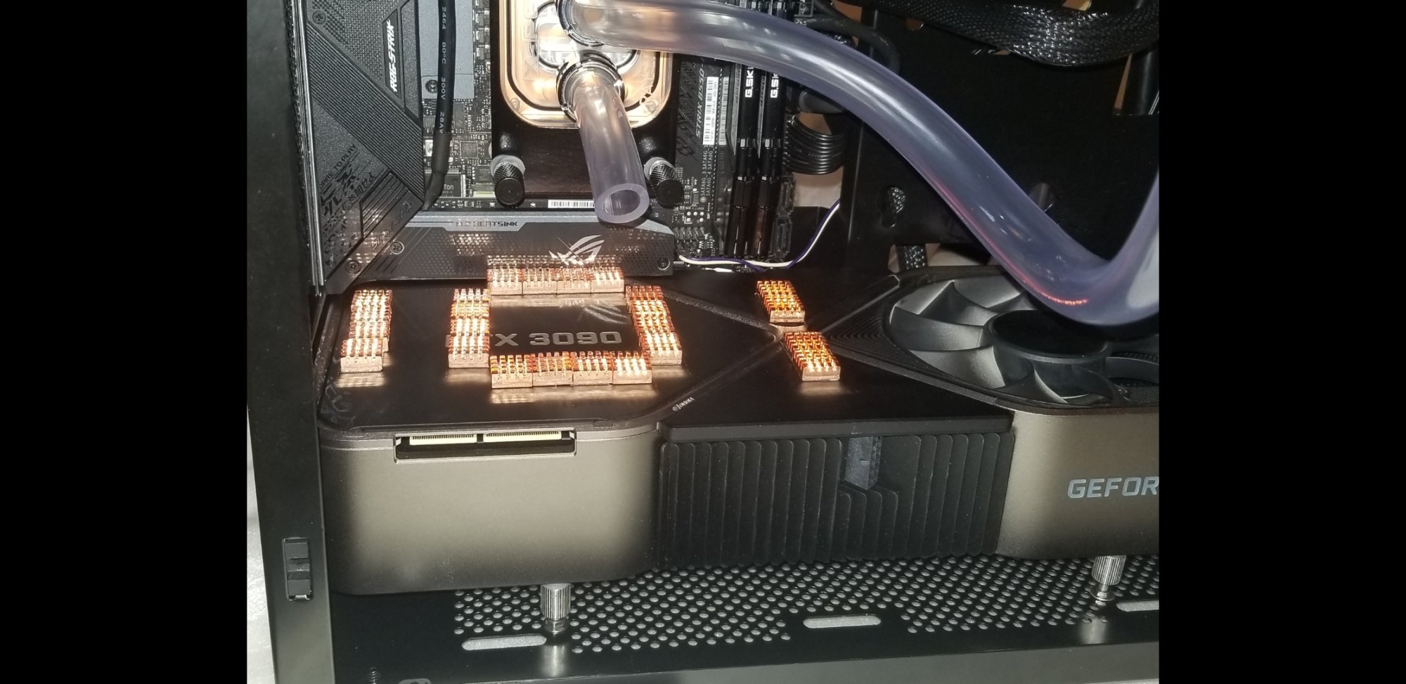

I never had throttling on my 3090fe but the fans would be over 80% on auto. New thermal pads on the back only and copper heatsinks I'm down to 100-102c while mining with fan on auto doing about 60%. Setting fan to 80% gets me down to 94-96c.
Maybe it's luck of the draw, but 3090 FE (stock) = VRM/mem heating issues. 3080 FE (stock) has been OK for me. I've been most impressed with MSI's SUPRIM cooling setup if you are talking about "stock". Gigabyte's AORUS XTREME is OK, too. But SUPRIM really kills the heat. I prefer not to futz with the cards as-is for warranty/re-sell concerns.
I'm guessing you mean copper heatsinks on the backplate?
Something like these over the memory locations?

^ wow are those just on the housing or are there dremel holes or something? That helps just based on sitting on the housing of the card?
Yikes. Yeah, I think i'll just keep using mine and not thinking about it. No way I'm looking at that.
If the backplate on the card is getting hot, then that means there's effective heat transfer to the backplate, so it would definitely be helpful to pull the heat off of it.
