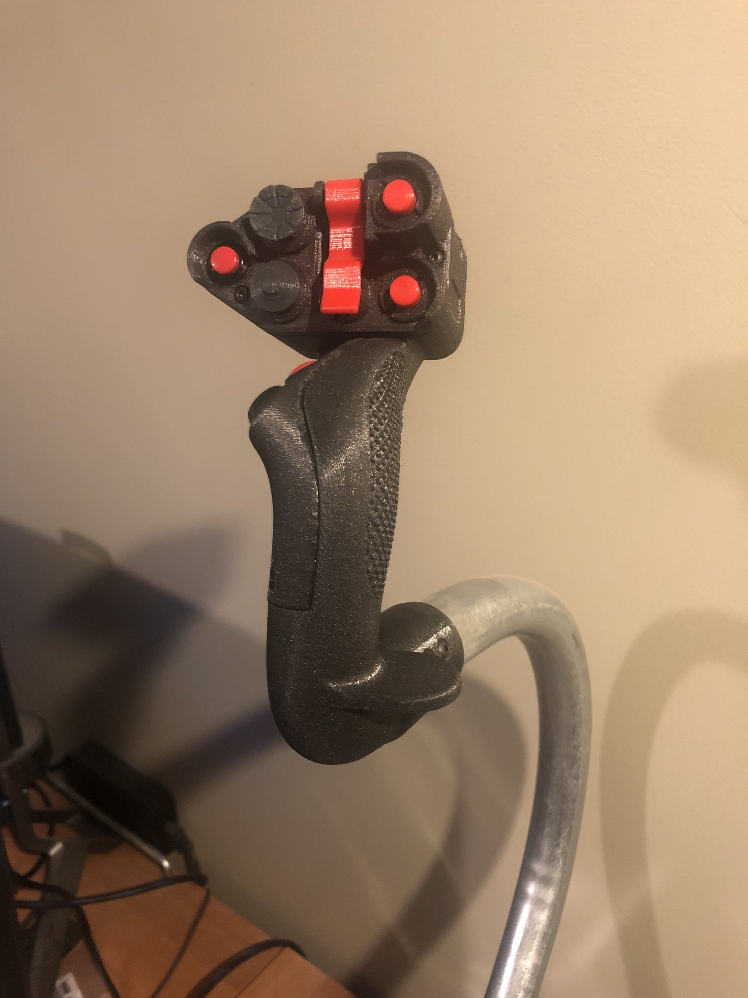

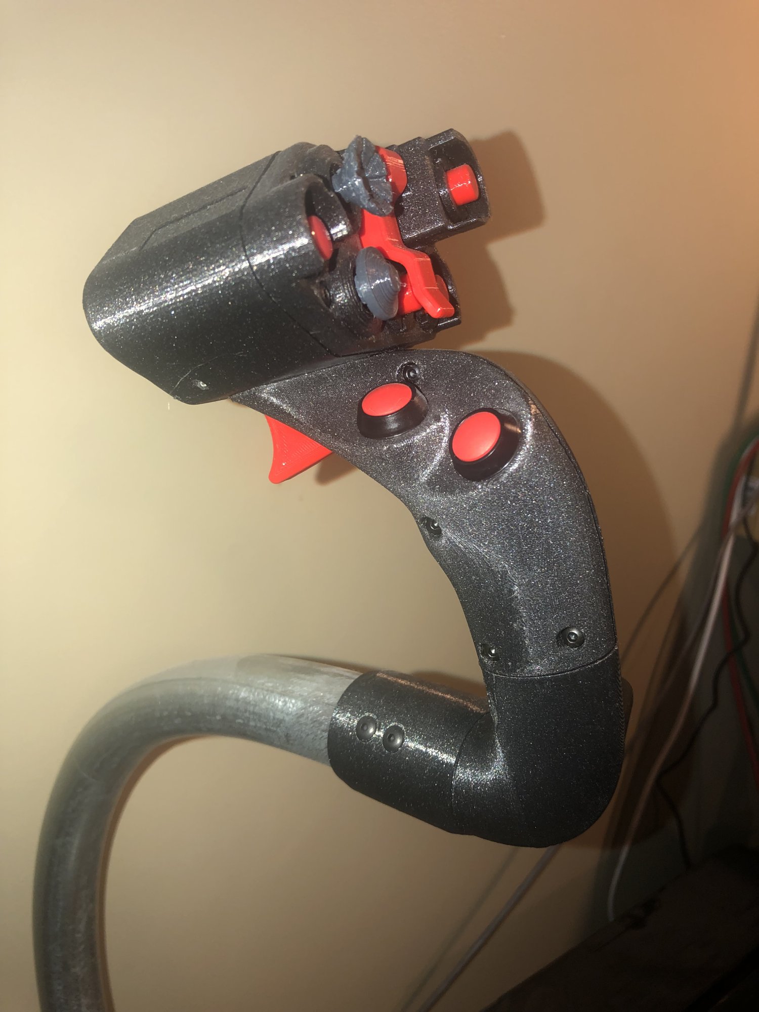

I found a really good model of a helicopter cyclic grip and modified it to suit my needs including beefing up the adapter and mounting surfaces where the handle meets the 1" EMT shaft.
Most of what you see in these photos was printed on a Prusa I3-MK3s including some of the buttons which have tactile SMT micro-switches underneath, the low profile ones are a part from DigiKey.

View attachment 518043View attachment 518044
that is amazing to me. Wow.
