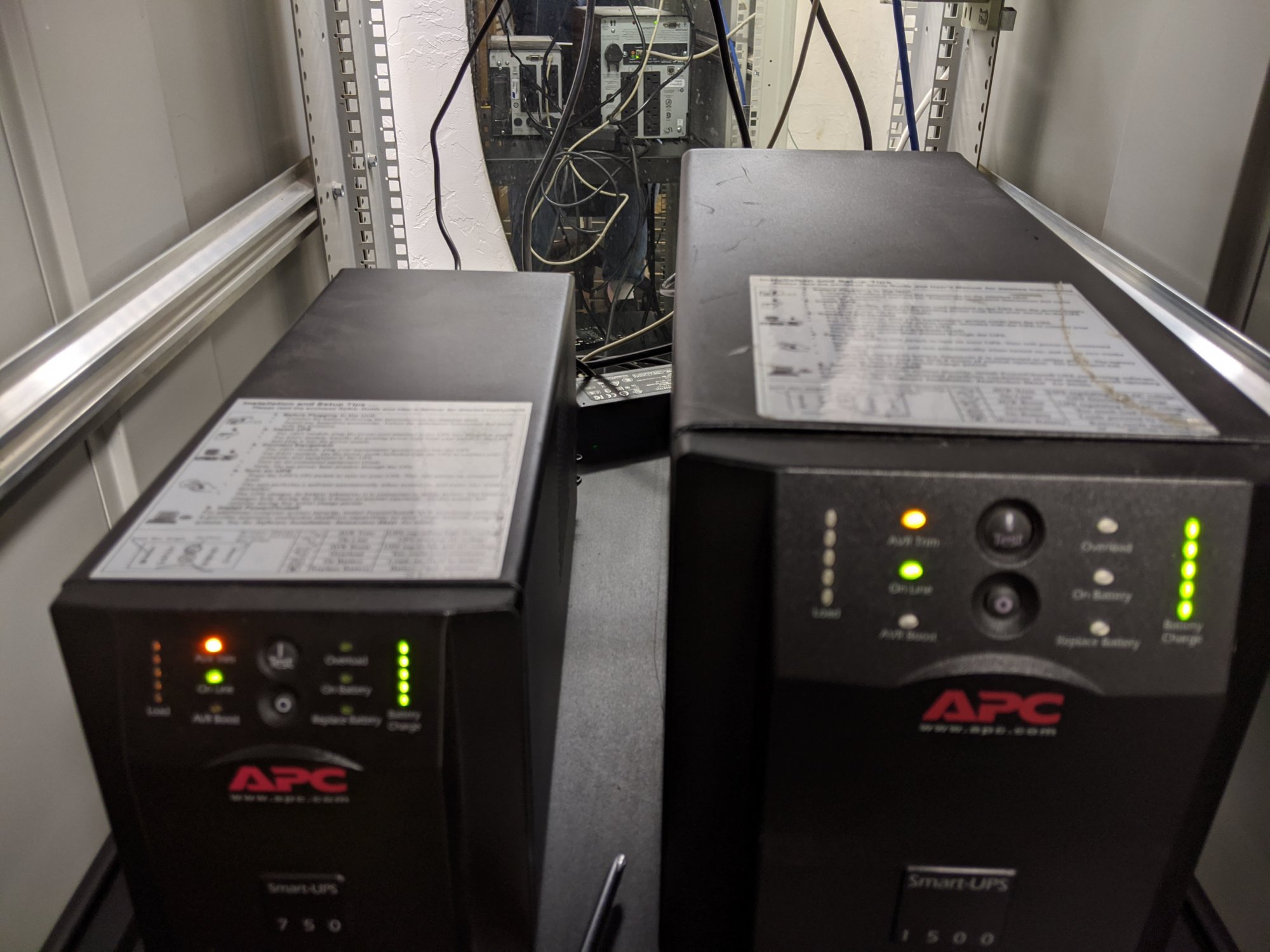

We are in the process of moving in to a new house. I'm setting up my rack in my new server room, and both of my APC Smart-UPS units are spending a lot of time in "AVR Trim" mode, which means they have detected too high line voltage, and are adjusting it down for the equipment.
US line voltage spec is 120V +/- 5%, so a range of 114V to 126V.
I've been monitoring the line voltage using my APC units every now and then. They drift in and out of AVR mode. When the AVR LED's are lit up, I read a line voltage of ~127.5V, which is above spec. The AVR LED's are lit up about half the time. I'm guessing the line voltage is flirting with the upper specification limit.
