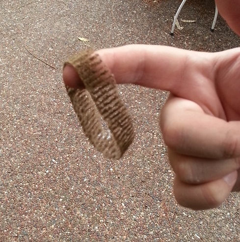

Plus you get a free ring every time you clean it.
