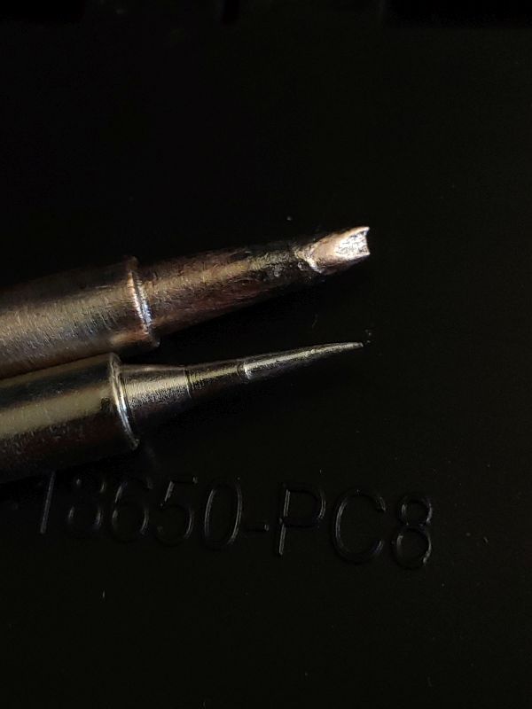

I'm no electrical engineer, but recapping electrolytics doesn't require anything special. A $12 PID soldering iron will do, as long as you can get, or it comes with what sometimes is called a modified chisel tip. It sort of cradles the lead and spreads the heat faster reducing extraction time. A regular chisel tip is still a couple steps above the regular pointy tip many leave on the iron full-time.
