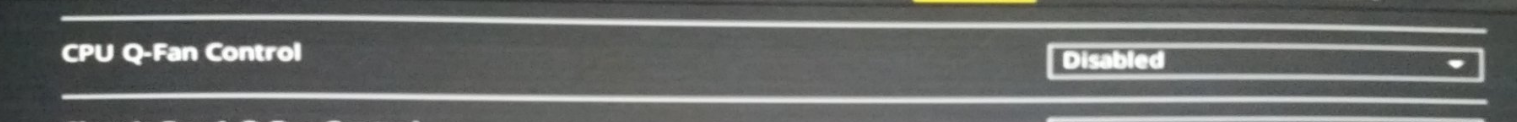

Yes The 2 noctura are in a splitter the end of that splitter is a 3 pin. Why can't I control the speed of the 2 fans on the cooler and why are they locked into one speed no matter temps? In bios I can't even see the speeds of the 2 fans on the cooler. I can only see the speeds of the fans on the case. Bios can only control the fan speeds on case and not the cooler either.
if it has chassis fan control it will have cpu fan control. dig deeper in your bios or maybe post your mobo and ill see if i can find it.
Here is a picture of bios lmk if you need more specific
turn that on to DC amd you should be able to at least use one of the profiles at the bottom or look under qfan(f6) to see if it will let you make a curve.

icue doesnt work to control the fans on our aios, the fans plug into the mobo.
When I click on q fan tuning it says above pic. When u set to DC it shows like wise

Didn't do anything changing the bios q fan settings. As you can see the fans are still locked in at 1084 and 1057 rpms....

thats because they are at 60%. lower the min duty cycle to 30% and increase the middle temp to 50c if you can.
