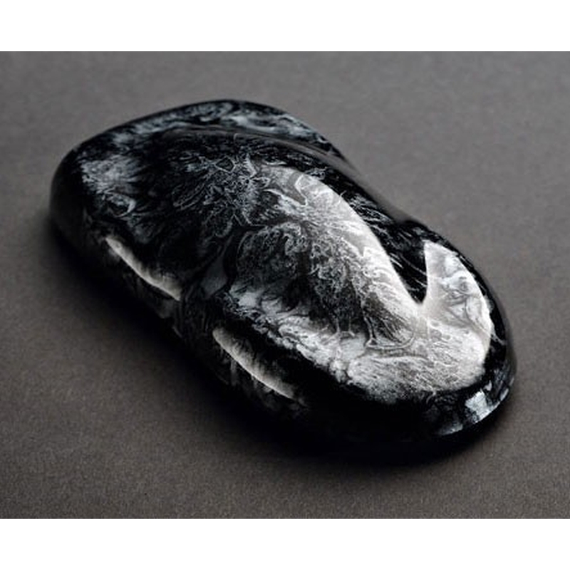

I'm looking to do a complete marble paintjob on the next one. Black Base with Silver Marble.. Something like like this.
But a slight hint of blue kandy and blue pearl.
