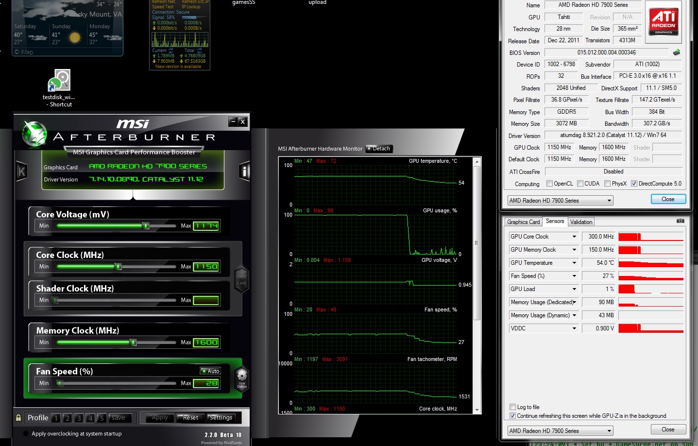

i'm having a similar experience with AB. if i do not unlock voltage control in AB then i can run it without it affecting the voltage. but as soon as i unlock voltage control, and without touching the slider, it automatically defaults to 1.17V which i think is higher than my card's default because the temps rise immediately. same thing with Trixx; if i set the voltage slider to the lowest setting of 1.17V i get higher temps than if i had never started the program to begin with. i also gain overclocking headroom with Trixx at 1.17V.
I am having very similar problems as well running afterburner or ASUS gpu tweak my cards read out at 1.050 for defaul voltage at first but if I touch anything they jump to 1.17 default and the lowest it will let me set them is 1.10.
additionally the highest clocks I can hit via CCC overdrive is 1075 mhz but in afterburner at 1.10 (supposedly less than stock volts I can do 1125 easily.
also at load (Running 3d mark 11) after burner teels me my card does not go over 1.10 volts but gpu-z says it's hitting 1.17.
and finally after burner also shows occasional voltage spike ranging from 1.3-1.5 volts (im pretty sure those are not correct and they only last for 1.2 of a second but it's still disconcerting.
not sure whats going on but something doesn't add up.
Also should we make a new thread about this issue?
at the moment gpu-z reports the target voltage while AB reports the actual voltage.
my card was doing the same thing. not sure if it's by design or just a quirk of the AB beta.
