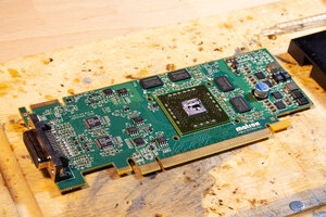

On the healing bench today, we have a really special guest, graciously provided by our very own Halon, in this Matrox M9120 Plus, which seems to have a little problem powering on.
Matrox is not a name you hear very often anymore, but they're actually still around, making really specialized PC parts, including, as I understand it, this card. Yes, that's right, this is a graphics card with 512MB of DDR2 memory, and you can actually go out and buy a brand new one right now. Maybe. If you can find somewhere that actually sells them. From what I can tell, these are typically used in specialized applications like medical imaging devices, where image quality and stability matter more than cutting edge features or compute performance. I'm curious what Halon was using it for - maybe he'll chime in later.

One thing I noticed is that the card is warped ever so slightly, probably thanks to the mounting pressure of the heatsink. It's not perfectly flat. It wouldn't totally shock me to find out that the reason it doesn't work is that there's a broken trace somewhere inside the card, but that's just speculation at this point. It could also be a broken solder ball under the GPU, or one of the other BGA chips on the board.
Here it is with the heatsink removed. The etching on the die is surprisingly deep. They clearly weren't terribly worried about cooling. The TIM was hard as a rock, too. Not surprising for a card this old, I guess. There's no evidence of corrosion or physical damage that I can see, though. It's surprisingly clean for a used card of this age.
After a couple of hours of soaking with isopropanol, I was able to soften the TIM enough to scrape it off with an old gift card and my fingernail.
