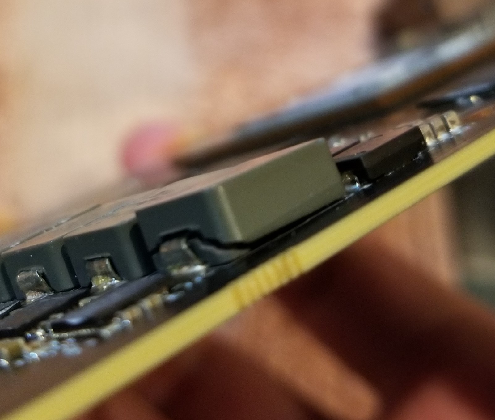

I'm in the US. Attached a picture of the VRM. Nothing pulled off the board, but the casing is cracked.
I put the card in the freezer overnight then used some pliers to gently twist the heatsinks off. Thought it had worked pretty well until I noticed the crack the next day.

That Choke can be replaced reasonably easily by someone competent in desoldering

The component in question is called a choke, or inductor. It's a part of the VRM, but does not require cooling under normal circumstances. The smaller, flatter components to the left of it in the photo are the power stages, and it's those that actually require cooling.
The visible damage here is absolutely repairable. I could probably do it for you if you're local to me in Central Texas, or if you care to send the card to me, but there are probably shops closer to you that could also do it, if you don't care to send this card to a stranger from the internet.

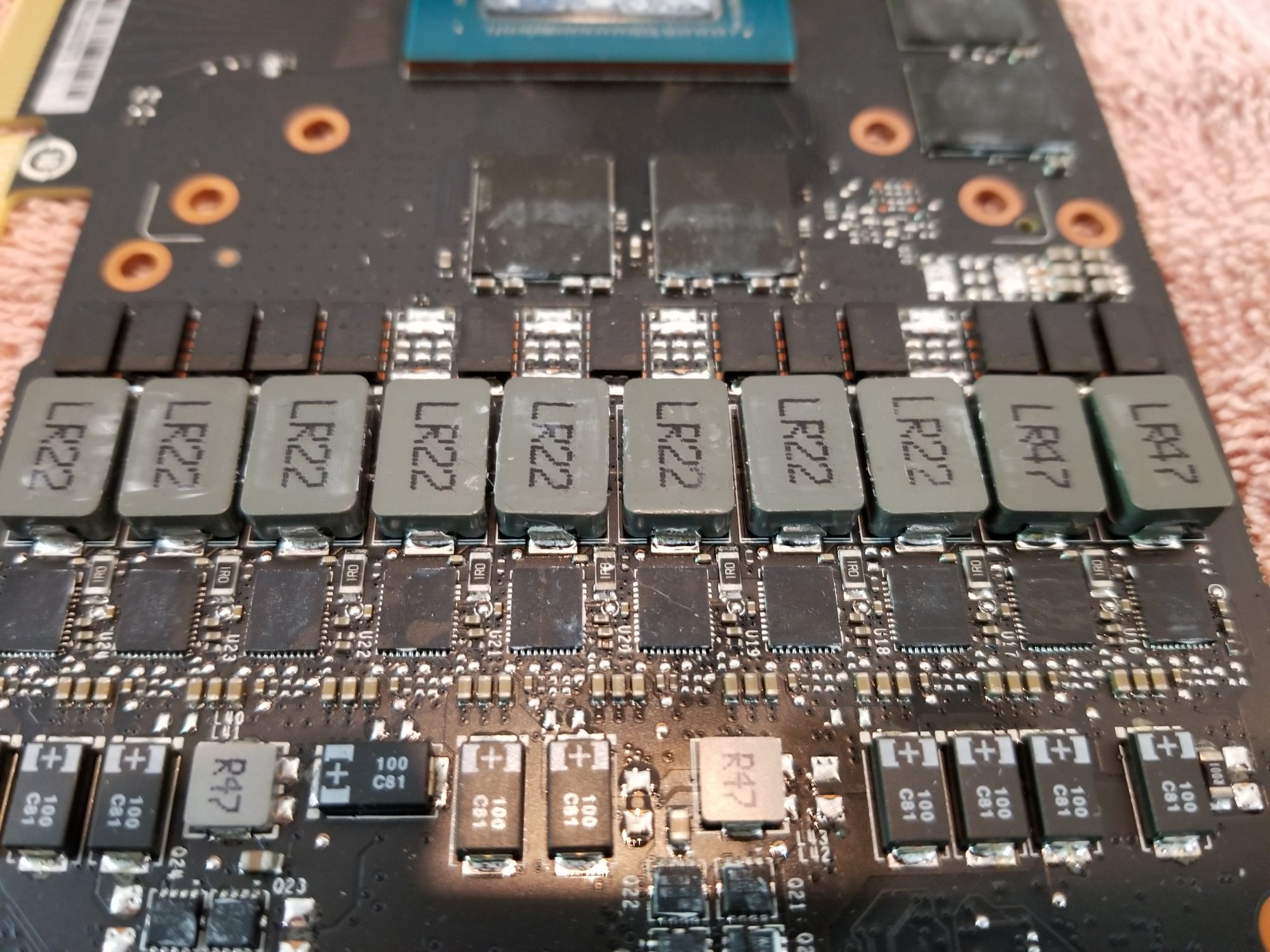

Can you post another photo from the top down, so we can read the labels on the components?

Here is a top-down view:
Good news that it sounds like the choke could be replaced!

I think the choke on the OPs card is 470nH, which are readily available, it just needs the right package type and from the same manufacturer to match the other chokes. Some of the other chokes look suspect as well, like the pick and place machine assembling the card didn't use enough solder paste.
