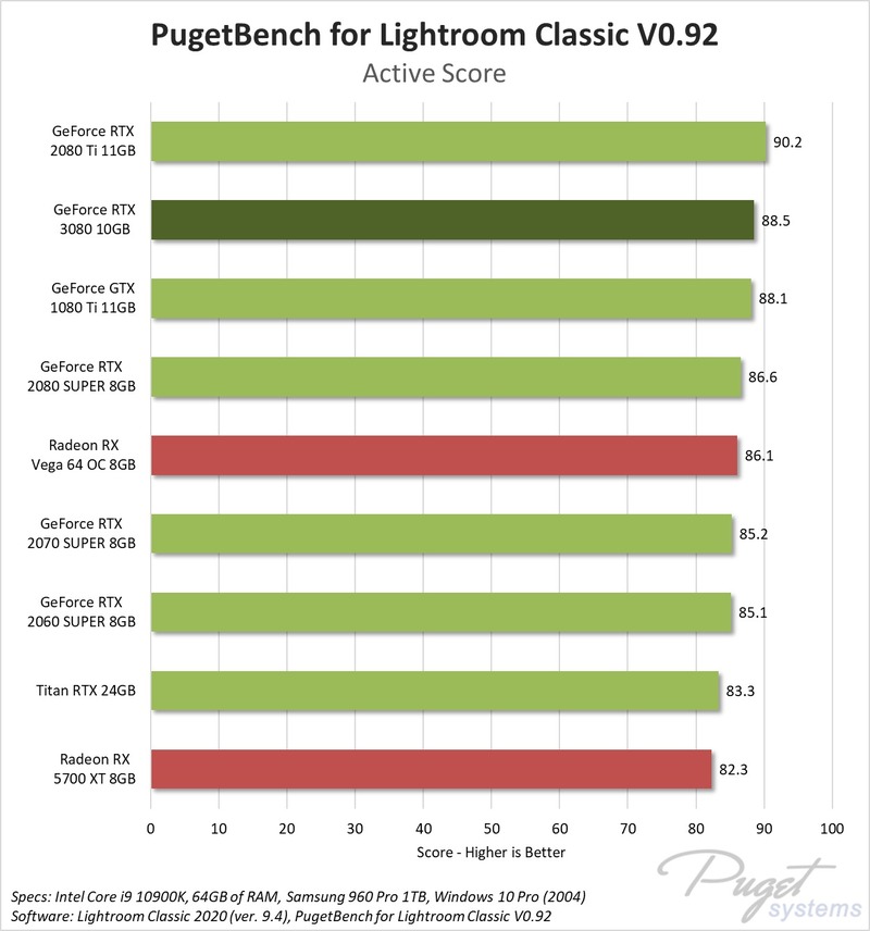

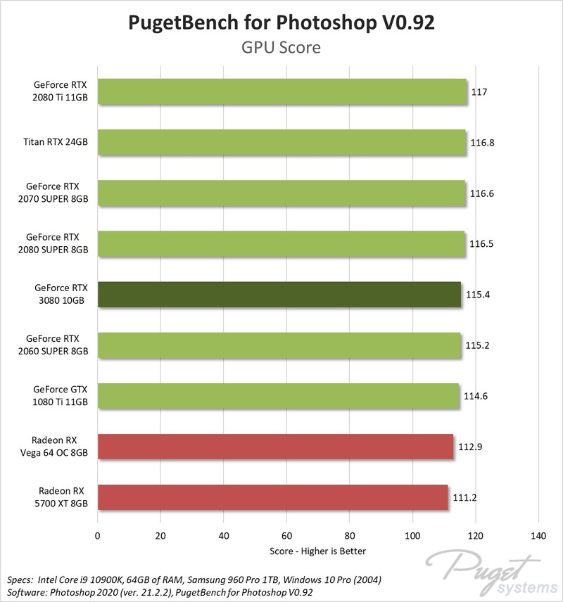

I build my own desktops, and photo processing, not gaming, is definitely the use case which drives my choices. For my use case, Puget Systems is a better 'review site' than all the gamer-oriented sites. And so far, Puget Systems is saying that for Lightroom and Photoshop, there is no reason to spend extra $$$ for a higher-performing GPU card. That's why I'm holding out for the 3060. If there is going to be a 3050 available about the same time as the 3060, I might even go for that model.

I thing it is important versus no GPU at all (and a modern one that have the , but it can quickly be a lot of money for any performance gain the moment you go above the entry offering, this website proposed is a nice ressource:
https://www.pugetsystems.com/labs/articles/NVIDIA-GeForce-RTX-3080-10GB-Review-Roundup-1879/
Anything above a xx60 could be entering margin of error for some workloads, still an interesting question if turin/ampere bring anything useful over a 1060 type of card too, if they do a 2060 or a 3050 would probably the go to choice.
