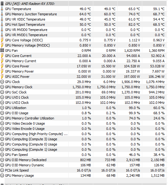

Thats after like 15 minutes in the witcher. Hit 1906mhz and 1.112v
Third column is max readings.

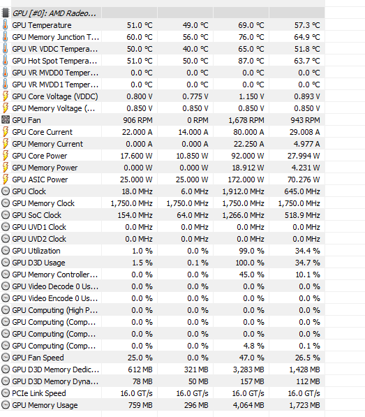

XFX DD Ultra here. Just put it in my PC out of curiosity. I have a 1080ti that I will be using and this one will be for sale but so far this one is stable. The really odd thing is its like XFX unlocked the hard limit AMD put on the clocks already. This is performing within 3-5% of an XT already.

Yes, DDU with the latest drivers in this case. Its stressing right now and temps are honestly not bad either. Junction temp is staying under 100c mem temps are under 90c and noise is acceptable.

Yes booted straight out of box. You want a copy of my Vbios just in case?
I let it run some superposition for about an hour and i am baffled. This card is much more stable and cooler running than the reviews suggest and it's running at a nice boost. I need to pull up my old vanilla red devil benches to compare. I might keep this card. It's function is overcoming it's McDonald's plastic cheapness.
