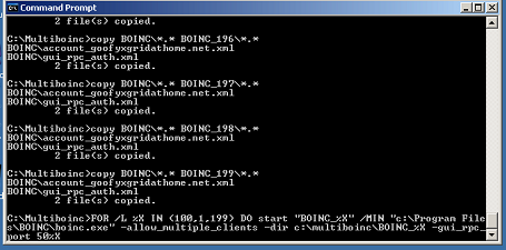

Next, type
FOR /L %X IN (100,1,199) DO copy BOINC\*.* BOINC_%X\*.*
hit Enter
It should copy a couple files into each of those directories

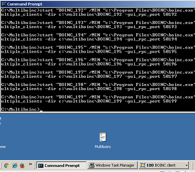

Now that you have the multi-clients set up, you will want to run the command to start them all.
From the command prompt type:
FOR /L %X IN (100,1,199) DO start "BOINC_%X" /MIN "c:\Program Files\BOINC\boinc.exe" -allow_multiple_clients -dir c:\Multiboinc\BOINC_%X -gui_rpc_port 50%X
Hit Enter and you should see 100 clients start up. When the clients first start up, it will peg the CPU due to BOINC running benchmarks on each client. This will go down once it has finished.
