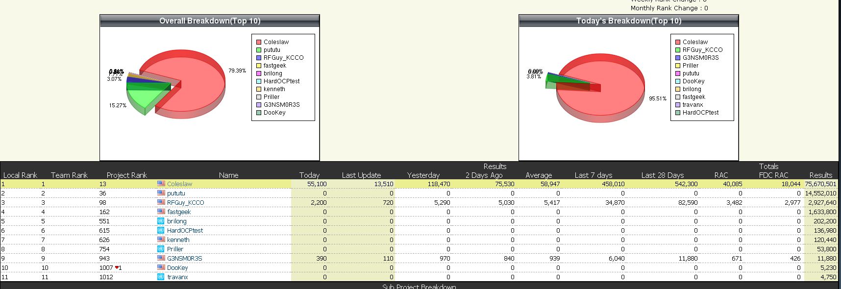

Just letting everyone know that they now also support Android ARM devices. They have applications for both PIE and non-PIE devices. (not to be confused with Raspberry Pi which they also have work for)
Starting to ramp up production now that it is part of the DC-Vault and some other teams are cranking out a lot of production.

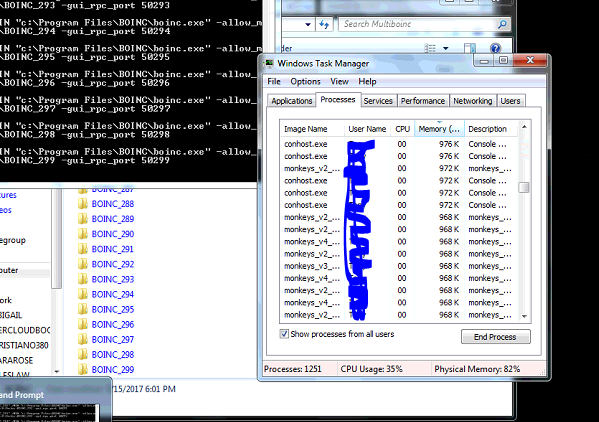

I get the abort/run, abort/run as well. The points are setup so that the only way to get the higher rank badges are either thousands of computers or thousands of clients. Admin agrees to it and has said its ok to run multiple clients. I have a few clients setup as well but I don't go as far as dedicating gb of memory to this and making this the top RAC project. Those getting several million a day from WUs that are 10points/hr is a bit extreme IMO.
An outdated discarded dual core laptop with 2GB+ RAM can pretty much handle 100-200 clients without much trouble....
Kinda like my file server that has only 8 cores but 48GB DDR2 Ram... can easily run a ton of clients and still DC elsewhere...
I see over 100mb per instance with WUProp going off the memory usage reported to BM.
I don't put WUProp on them all. Find that as a poor way to skim credit from WUProp in the process of trying to claim CPU hours for the badge bump. Simply put, there is no value to collecting data on that many goofy work units from multi-clients.
My laptop shows under Resource monitor
Each Goofy app using ~4.8MB
BOINC client using 20MB
BOINC Manager using 30MB
WUProp using 5.8MB

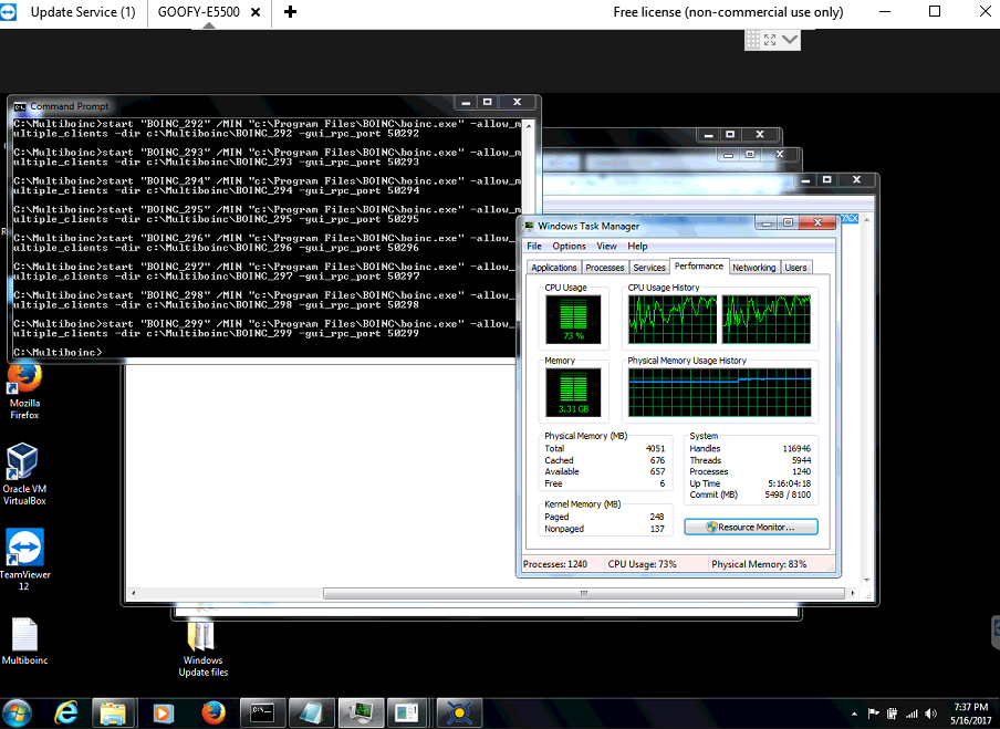

The multi-clients don't have the manager over head. So, Client + 4 apps = 40MB each. 100 clients is essentially 4GB. Since virtual memory can still handle some of these... well..that is just the math from this laptop. I have seen the clients not actually use that amount the whole time. Reality is a different thing. Here is a screen shot of a laptop with 4GB RAM and running 200 clients.
I had also mentioned thousands. With that many it wouldn't be need to run WUProp for just goofy. I only made it to 38-42k hours before Goofy was moved to GCC. Now it starts over again.
After checking WUProp memory usage, just by looking a BoincTasks, Mint is using 68mb while Ubuntu is 19mb and Win7 at 24mb. All of the instances on the Mint PC are at 68mb even with just a couple of projects attached. It seems to vary more by the # of cores than anything else. Mint machine has 32, Win7 with 8 and Ubuntu with 4. More to keep track of I guess.
Yes, but most people are spreading those thousands across more than one system. I find it to have less problems by doing that. I've ran over a thousand on a single server with multiple VM's. However, when running multiple clients, I find much better results just keeping it on the host OS. But, the headaches that comes from poorly written apps taking over a full core each every now and again to be worth the VM.
