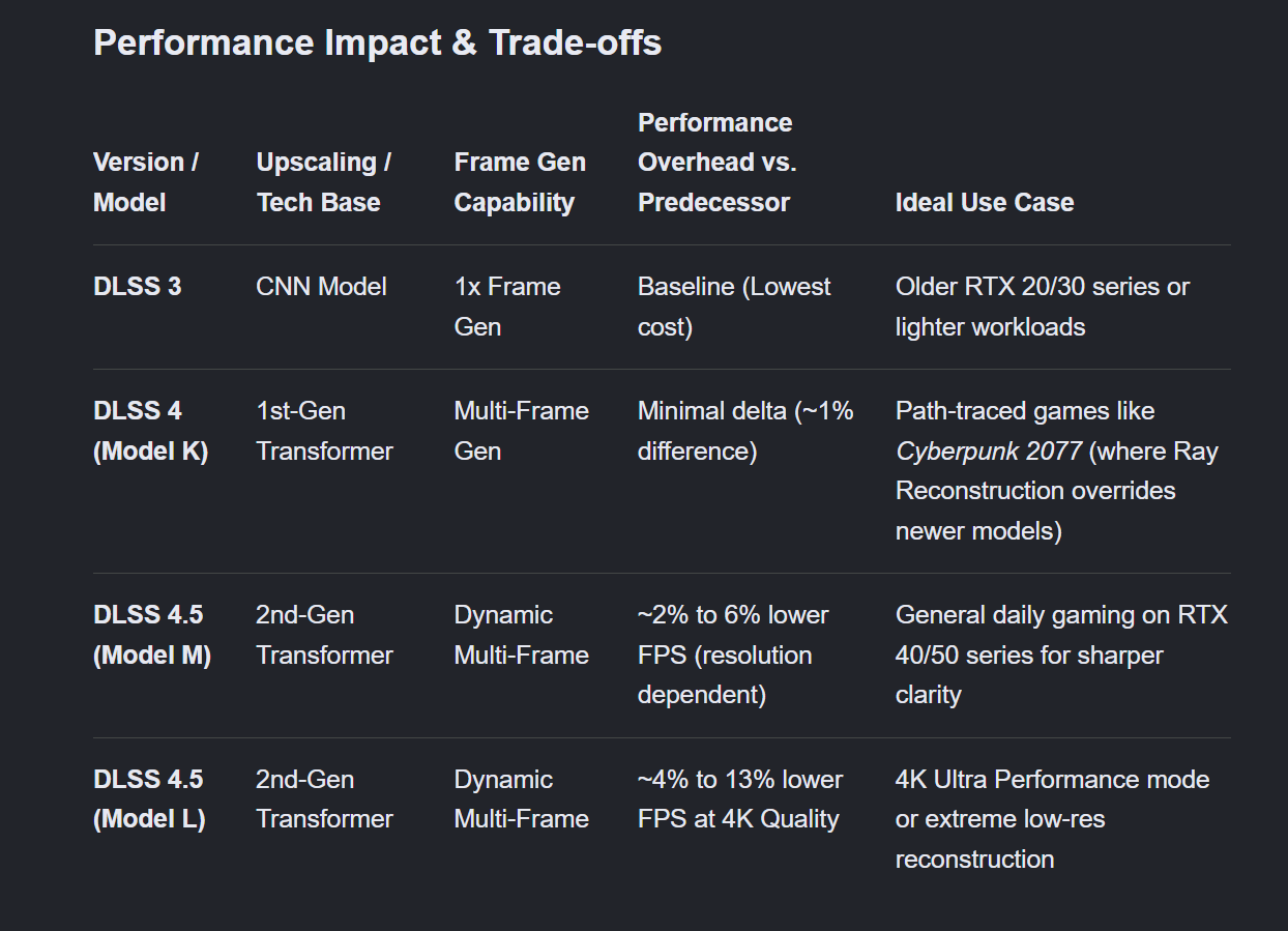

This chart more/less confirms what I said.
For example, 13% of 136fps, is 17.68.
136fps is what I was getting in the Monster Hunter Wilds Benchmark at 1440p Quality, DLSS 3 Preset "C" with an RTX 5080. And in the same benchmark with the same settings: DLSS 4.5 Preset L "was close to 20 frames slower".
**Different games load the GPU differently. Some games will show relatively less framerate hit, as per the chart stating as little as 4%. There's also different GPUs, with different amounts of Tensor cores**
