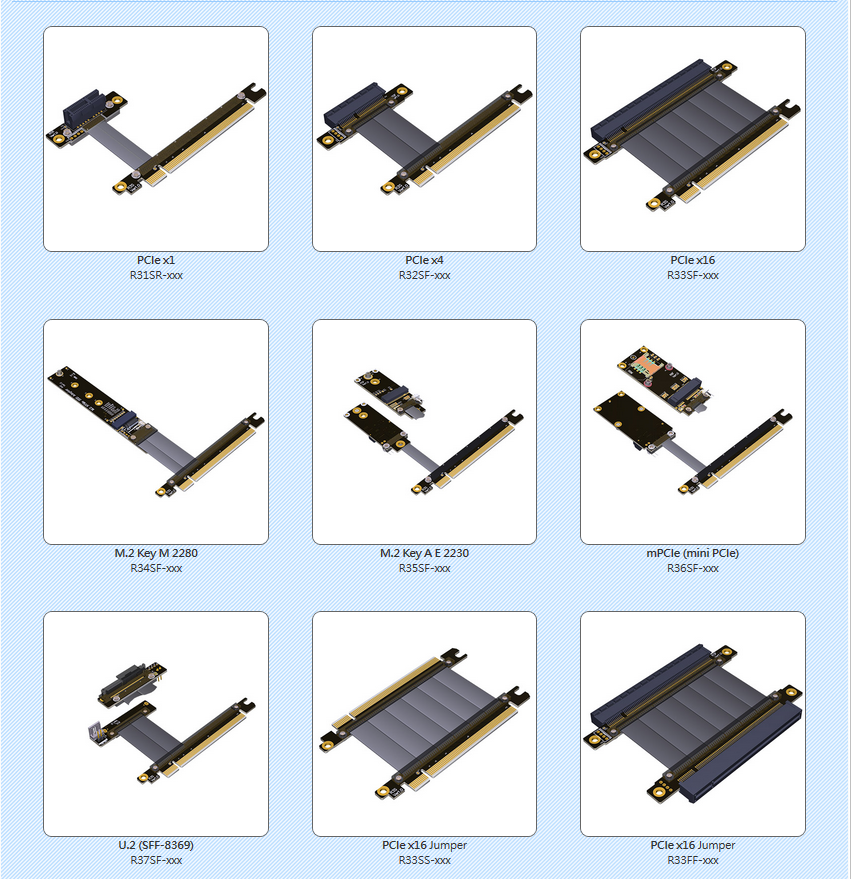

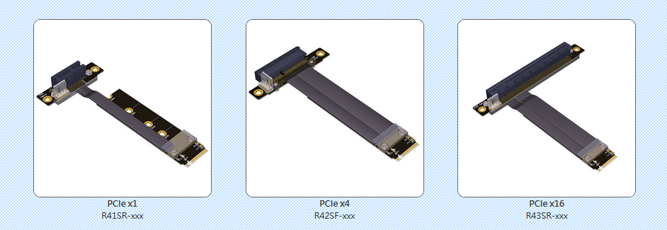

BPlus riser R3y series for PCI-E 16x and R4y series for NGFF M.2 (M-key, PCI-E 4x):
For price i found this (around 50US)http://www.era-adapter.com/pcie-x16-cables-c-92.html

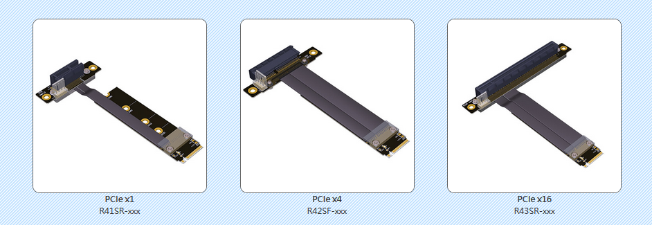

This R4y looks interesting:
