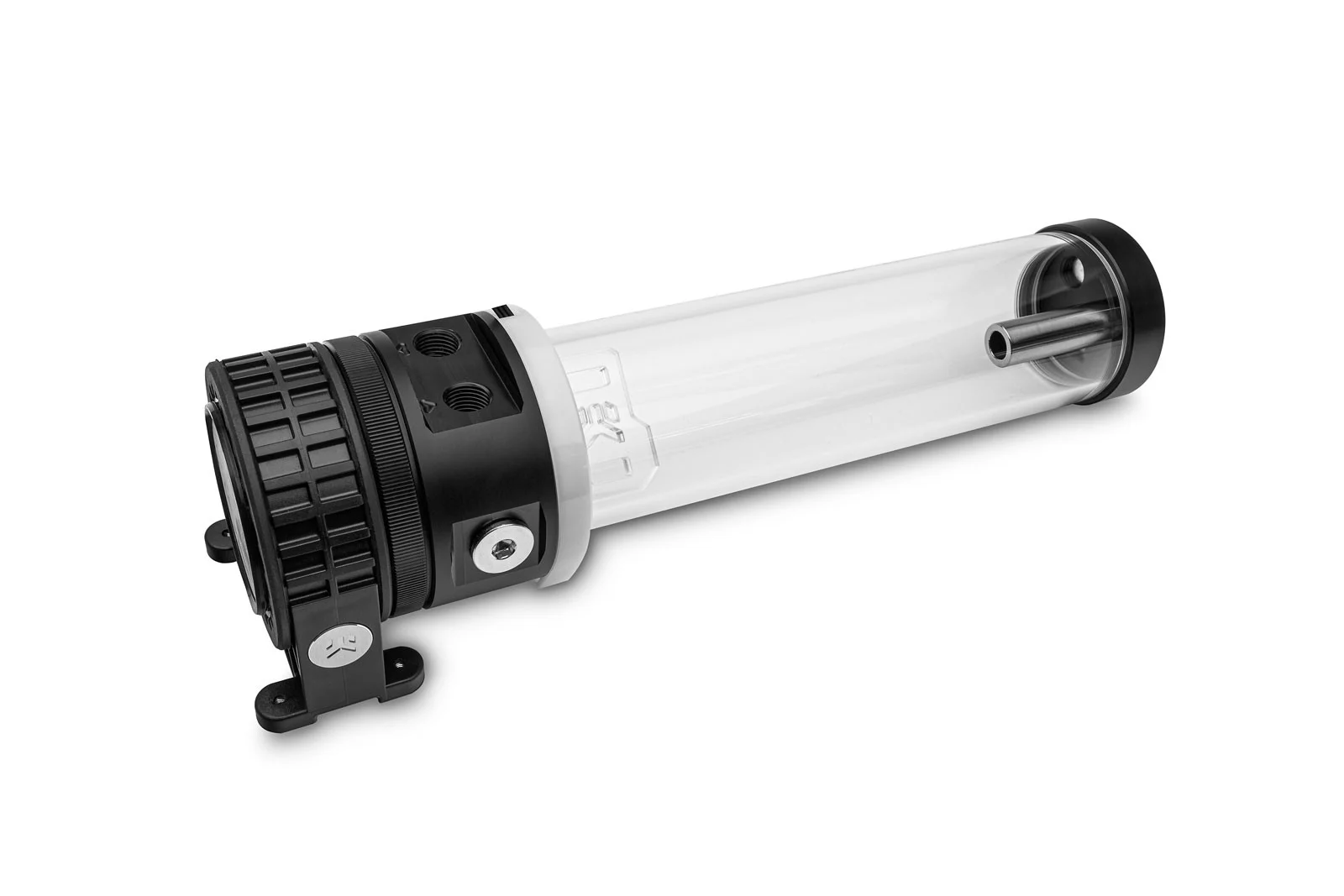

Pump/ Res : EK Quantum Kinetic TBE 200 D5 RGB

Fried One, looking at your parts list you will need one of these https://www.amazon.com/EKWB-EK-UNI-Bracket-120mm-Vertical/dp/B015ONJZ12 to mount that pump/res. I do not think it is included. Also, just for fun, check out this guy https://www.youtube.com/channel/UCr1J-4O7J2oMhmn1aSVwCpQ/videos singularity does great stuff but I really like this guy.
Hey Smoked,
I totally overlooked the bracket. I was under the impression that the bracket with the rubber insert that fits around the res can be mounted to the backplate of the case. Will check it out. The bracket you mentioned is if you wanted to mount the pump/res on case floor. I will need to clarify this. Awesome link ...thanks will check him out.

It does look like this mounting clip is included.
I'm trying to decide if I think that one clip at the bottom is sufficient to hold it. Probably is.

The bracket will give you the option to mount on the radiator or floor, or even come off the radiator vertically or any 120mm fan mount point. That included plastic clip doesn't offer much versatility. You could also just get this https://www.amazon.com/EKWB-EK-UNI-Pump-Bracket-120mm/dp/B015ONJYFO The link I gave before is a high price, your in Australia, I know, but I would consider this reasonable https://www.performance-pcs.com/wat...120mm-fan-vertical-ek-uni-pumpbk-120vert.html

That included clip will not mount to a 120mm fan or rad, you need one of the seperate brackets.

I will be mounting this pump /res to my case frame. I picked up some acrylic today. Going to make a power supply shroud to cover floor of case. Also going to make a back board where the pump is going to mounted. Going to give it a shot. I received my order today of CPU block, rrad , pump res combo and some other items as well.

Opened your link for the bracket at Amazon. I am not in Australia but in Canada. Singularity's Proton Pump and res was my first choice but the res was pretty expensive and it did not include a pump. I chose the EK because it included the D5 pump. Now Amazon here in Canada is asking $45.19 for the bracket plus $99.00 for shipping. WTF!!!
