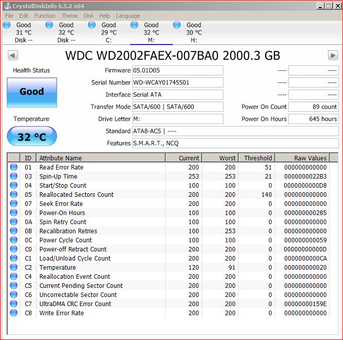

Run crystal diskinfo and post a screen cap.. Should give a lot more informatuion than what you are saying.
here you go. doesn't seem too bad from what I understand. Not the drive is now connected on the mobo's internal SATA controller... I'm not plugging it in that enclosure any more!

smart info says that drive is in great shape and hardly used.
It has a lot of ultraDMA crc errors which means the cable used to connect to the drive is faulty. The USB3 case and circuit might be okay but the cable or connector is not set properly.. Is it a cable or do you connect the bridge circuit directly to the drive? IF so the connector might have come lose or a bad soldier joint, can you visually check the connector to the circuit board of the bridge controller?
In fact for external enclosures, the connector to the drive or the USB cable are the main reasons for the external drive failure, the drive would still be good once connected to the motherboard SATA..
Also the drive wont get that hot unless you copy files for hours.. Place a fan to the vents of the enclosure, it wont work for heavy use but for a few hours it will work.. You could also run crystal diskinfo to check the temperature when it is working.. Its been a while since I seen a fan in an enclosure.. It dont even cost them a buck and the drive lasts twice as long, maybe they want the drives to fail faster hence dont put it in. I have not found a single one that stays under 40C and in fact the best drive that runs cold stays around 52C.. It stays under 40C with heavy use inside the computer case with the room being 30C..

Well that's reassuring. Is 5534 (159E) the error count?

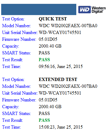

I also just finished an extended 4h+ Test using the Western Digital utilities to check for bad sectors, and it didn't find anything.

Yes but each of those errors makes windows think there is a data transfer error and causes problems. If the WD util says the drive is good after a surface scan then it most likely is fine. But it does look like the USB is definetely bad or have compatability problems. Only way to know is to try a different one and see if its the cable of USB bridge circuit or your USB3 port// You could also try it on a USB2 port or a different port. Things like this are a debugging scenerio where you waste hours trying to narrow it down to which part is not working properly. It could also be your USB plug was lose or not inserted properly all the way and any movement causes it to shake lose and cause errors.
