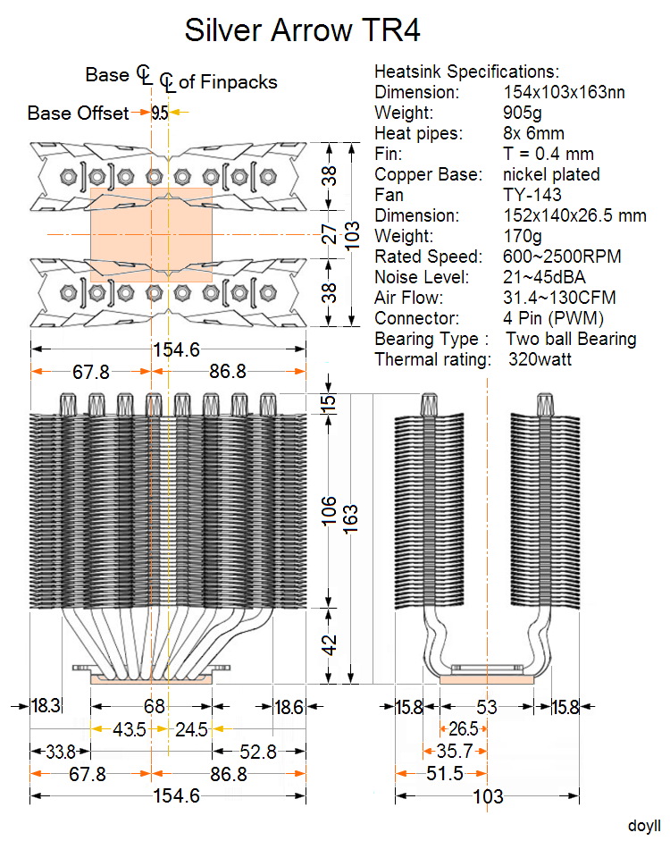

I swapped out the TY-143 fan for the Noctua NF-A15 Chromax 140mm fan and added a second one. It cools my TR 1950x very effectively however I am concerned it will effectively cool the TR 3960x which I am thinking about upgrading to. I am also thinking about the 3950x and the only air cooler I would consider is the Thermalright Le Grand Macho RT but not sure this will effectively cool the 3950x. I have not considered a custom water loop because it seems like a headache with having to periodically change the coolant plus heard many stories about leaking issues at some point in time. Somebody once said water and computers don't mix. What are your thoughts?No problem. Glad I can help.
No, twin tower coolers with only middle fan perform within a couple degrees of 2x fans in push / push. In fact single middle fan on twin towers cool the same at same noise level as 2x fans in push / push. Reason is while 2x fans do flow a little more air though cooler, single fan makes about 3dB less noise, and if ran faster at same dB noise level it flow same amout of air as 2x fans at same dB, so same cooling.
[H]ard|OCP tested Silver Arrow TR4 when first out, but it was combined with Liqtech TR4 and a couple others, but that review was pulled I think becuase of the Liqtech TR4 problems. Initial testing Only ran TY-143 at half speed (1300rpm) and temps were not great, but when they re-tested and ran it full speed it actually cooled within 9.5c of fancy custom loop and better than Liqutech TR4.
Here's detailed dimensional drawing:

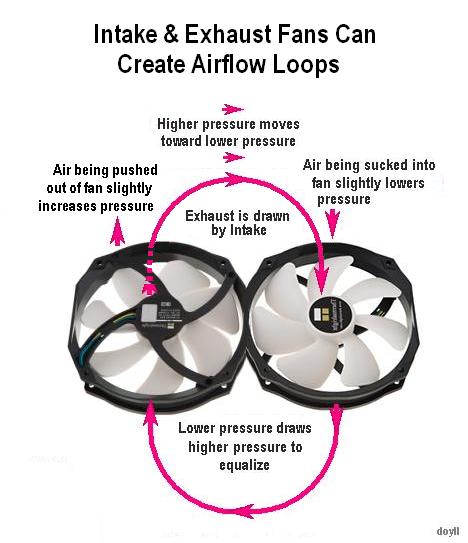

Thanks! Here is my thought process for the top of the case with the 3 fans, one exhaust and two intake. Please don't laugh: The two fans closest to the front of the case will bring a lot of air onto the heat sink and the fan in the rear will exhaust the warmer air. What do you recommend for the top fans? What grill on the bottom are you referring to with removing? As for the splitter hubs, my GPU (Nvidia GTX 1050) never uses its fans because this rig is used exclusively for video encoding and taxes the processor so it seems like I would only need one splitter hub? For fans, I have two 150mm on the Silver Arrow, Two 140mm front intake, one 12mm intake on the bottom intake which I THINK IS A WASTE BECAUSE OF THE PSU COVER, and three 140mm on the top.Nice looking rig!
Hate to burst your bubble, but the intake & exhaust side by side in I assume top of case are moving air in a circle from one to the other.
