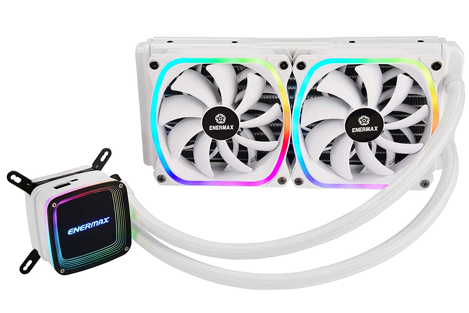

I just got this unit and I've never installed one. It has a 3 pin pump header the manual says to plug into the CPU fan header. Are these pumps suppose to run WFO 24-7?
Manual
They can be throttled back for noise, but WFO is how I've always ran all the pumps on a AIO
Would I do that using the voltage control option in the BIOS, since this doesn't have a 4 pin connector? Do some pumps come with PWM control? Thinking maybe I got the wrong on, here, damnit.
yeah, that's how I do it, just set that header to 100%
So does everyone just run pumps wide open?
Depends on the AIO/pump. I ran my Kraken x62 and H110 at 100% at all times because they were quiet even at max. My current one becomes louder than any fan I have at anything over ~60% so I keep it low for the quiet.

How do you adjust pump speed? On Amazon, Enermax answered my question:
Q: Is the pump suppose to run at full speed, or can you control pump speed thorugh the bios using the bios 3 pin votage control?
A: Pump is always on full speed to maximize heat dissipation. Fan speed is controllable through BIOS however
Really a stupid answer since you could run every everything WFO to "maximize heat dissapation."
Can you BIOS voltage option to control pump speed, or would that damage the pump? People report teh pump is dead silent wide open at 3200 RPM, but I just hate running anything WFO unless it is needed.
You can control the pump speed by reducing voltage, but you shouldn't on an AIO. Don't worry about running it full speed. It's designed to run that speed, it's not like you're redlining an engine here.
LOL, yeah that's how I feel about it! Anyway, the manual says to plug the pump into the CPU fan header, so I did. Booted to BIOS, and the MB immediately controlled the pump speed, using the default fan profile. The pump was running at 1850 RPMs, and the fans at 1450. Idle temps was 30C in a 22C room. So, for now, since the manual doesn't say ANYTHING about setting the BIOS to run full speed, I have a speed controlled AIO pump. If it fails due to undervolting, that's their problem. They should state that in the manual.
That's... a pretty cavalier attitude. I seriously doubt that they will consider it to be their problem.
The reason they tell you to plug it into the CPU header is so that if the pump fails to turn, your motherboard will see the 0 tach signal and react accordingly.
You should probably not leave it like it is. Set it to 100%. I've seen cases where the voltage controlled header dropped below the run voltage of the pump and it stopped with the machine running.

all mine run full blast.
no, that would be a you problem, but i doubt it would happen. leaving it on auto is going to be fine just potentially not optimal. but its your call. you can balance performance noise to your taste.

I took that information as valuable too. I don't want to undervolt it enough to cause it to stop running.
This is my first experience with AIO, but I have a bit of experience in other areas and I understand about undervolting and damage to certain motors, or them failing to even turn at all. Some will run with really low voltage, but it will wear out the motor faster or even cause it to fail:
This is a good overview:
  1. The device might have a starting circuit that’s only designed to run for a short period of time. Due to the undervoltage, the device may fail to start and thus leave the starting circuit on all the time, quickly destroying it. This can happen with some motors or lights.
  2. The device might have a regulator that supplies only the amount of power the device needs. With a lower voltage, the same power requires a higher current. The higher current may cause a device with a fixed resistance to overheat and fail. This is common in laptops and other digital electronics.
  3. The device may have some circuits that should never operate at the same time. Due to the undervoltage, the device’s control system does not properly start up or initialize, allowing circuits that must never operate at the same time to operate at the same time. This can happen with H-bridge motor controls and inverters.
  4. The device may use MOSFETs to switch high-power electronics. With an insufficient supply voltage, the MOSFET may not turn all the way on, leading to a higher on resistance than normal. This higher on resistance causes high power consumption in the MOSFET, causing it to overheat and fail. Source
And #5is that some motors are made to undervolt, just like most 3 pin fan motors have no problem with it. The only warning that was in the manual was that the CPU fan header may fail to power the pump.
I read on some review the pump speed was 3200RPMs, but the Enermax specs do not state the pumps max RPM. I'll find out tonight. It's max power draw is 0.7V.
i would recommend that you take it off auto, put it to full blast and see if the noise is ok. if not, turn it down a little at a time until it is and then leave it there. then you wont have to worry/overthink this silly non issue.
I was thinking about doing the same thing. I'd just have a flat fan curve profile at whatever speed is best. I cold also make the profile flat unless it starts to rise above X temperature, tehn allow it to run fluu out when or if needed. It's a good option. Thanks.
The max RPM is 3200. I set min state at 2400. I tested it at idle in the bios and no diff in temps all the way down to 1500RPMs. After 50C I have ramp to full. <shrugs>
that should be fine it will just go to full when then cpu is actually in use.
Finally got a reply back from Enermax:
"My motherboard does not have a pump header. I'm just asking will controlling the speed of the pump in the BIOS harm the pump?"
"Bios control pump speed won't harm the pump."
Best Regards,
LEPATEK CORP
Enermax USA RMA
