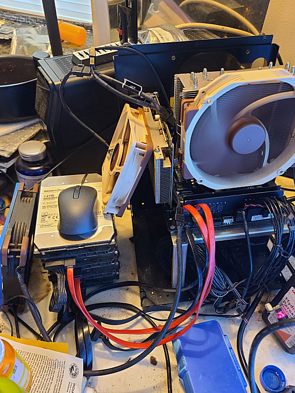

a picture of the current system as I type this.
the 4 x 3.5 stack has the rubber mounts spacing the drives 8mm apart and is about 150mm tall.
it reaches up to the motherboard in the case.
another 4 would reach the top of the case, adding no width.
a drive case using the angle mounts would block the side where I have the fan now.
a single 120 noctua ducted to the rear of the array sucking air from the wire end (towards us in the picture) would work.
the wad of wires could be managed, but I am not bothering atm.
the two empty motherboard USB sockets are in JUST the right place for this idea, running the other 4 drives.
the full stack of 8 drives would get in the way of the videocard fan, instead of providing handy support, so It goes on the other side of the case where there is no conflict.
yes. I need to do the GPU fan duct. but gpu temps are fine as is.

That is insane.
That is insane.
I like the symmetry of the setup, the drives are roughly the same size as the PSU, and as the cpu cooler and videocard.
the 8 drive thing could loom in the background.
I put the toaster where the mouse is in the picture. the video fan blows right on the circuit side of the vertical 3.5

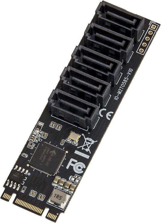

Have you considered a SATA port multiplier? Something like this.
SATA bandwidth would be shared across the drives depending on what's being accessed at the same time. So, it might not work depending on what you are doing.
Also, link is not a recommendation. Just an example of the tech.
sort of like running several drives into a usb hub plugged into 1 usb port.
that is why I am so giggly about the 2 drives per motherboard socket setup, no sharing.

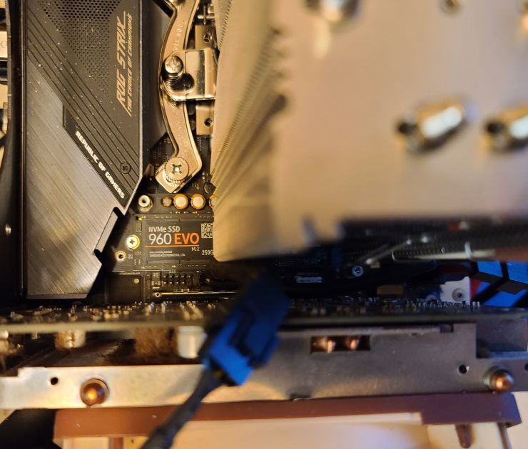

Looks like an M2 2280. Probably need a smaller one.
no, the available M.2 mount puts the socket end of the card directly under the CPU heatsink, so close that the sata wires cannot bend enough.
leaving only a couple sockets at the other end exposed enough to plug into.
going shorter, like to a 2240 would just eliminate the usable socket end.
https://hardforum.com/data/attachment-files/2022/08/707100_hg725.jpg
Could you mount that heatsink the other orientation? Pretty sure I could use my noctua in whatever direction I wanted.
never occurred to me.
the case has a 120mm fan mount directly behind the heatsink that I am focused on using for a ducted exhaust fan to the heatsink.
the duct to a 90° rotated HS would be complex and a nightmare for airflow. evil.
but it WOULD absolutely free up all the M.2 sata card ports, Good.
too bad the heatpipes are not flexy, with each pipe having its own independent array of fins, so I could sculpt the HS shape I want.
the heatpipes ARE bendable, but not much, and both ends of each pipe are solidly located by the spreader block at the bottom and the fin array at the top. so the bit that can actually be bent is limited to what is in between those two.
the previous board CPU heatsink design was laid out so that I could bend all the pipes at once and tilt the fin block so the duct would work better, the Noctua design geometry does not allow this at all.
I got one of these, but my motherboard uses a unique M.2 mounting scheme that blocks using it.
Hard to tell from the pictures, but would these work with that M.2.
How much vertical space to you have between the top of the M.2 SATA and your heatsink? These are very short and have a super flat cable.
I've used both when building in tight setups.
You need one of these:
m.2 extension cable
There are other lengths available if that isn't long enough to clear what needs to be cleared.
not a great picture, but that is the setup.
VERY little clearance.
three sockets might clear enough for plugs but no way the plugs in the barcode area will clear the heatpipes.
Indeed. It does not even look like the M.2 card would fit with nothing plugged in.

What you are trying to do via USB is going to add more points of failure regardless (i.e. USB <-> SATA converter will be required for each drive).
Given the concerns with points of failure... I think your best bet would be to replace the heatsink with something that would allow you to use the M.2 SATA card.
You appear to be at the point where your hardware capacity / capability and your concerns are conflicting. To push this hardware further, your probably going to have to compromise your concerns to some degree.
Personally, I would avoid using USB as a long term live data storage conduit (my own personal bias / concern).
definitely under consideration.
the context of its selection was my computer died requiring a new MB and CPU, generational changes to the mount required a new cooler.
the U14 was because I needed something RIGHT NOW that I could rely on being adequate for permanent use.
its actual configuration is suboptimal in several respects.
yes, I would likely have to grind on some of the sata plug guards to gain clearance.
I am wondering about that, the USB to 2.5 drive adapters seem to be simple plugs, and the main difference with the 3.5 plug is it needs 12v power.
so what is the "USB <-> SATA converter" that I have been assuming must be required ?
I have thought of getting a 2.5 adapter, and cutting off the power half of the drive plug to clear a PSU sata power plug.
