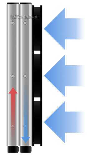

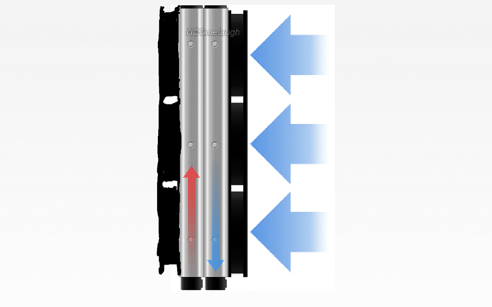

View attachment 441319View attachment 441320

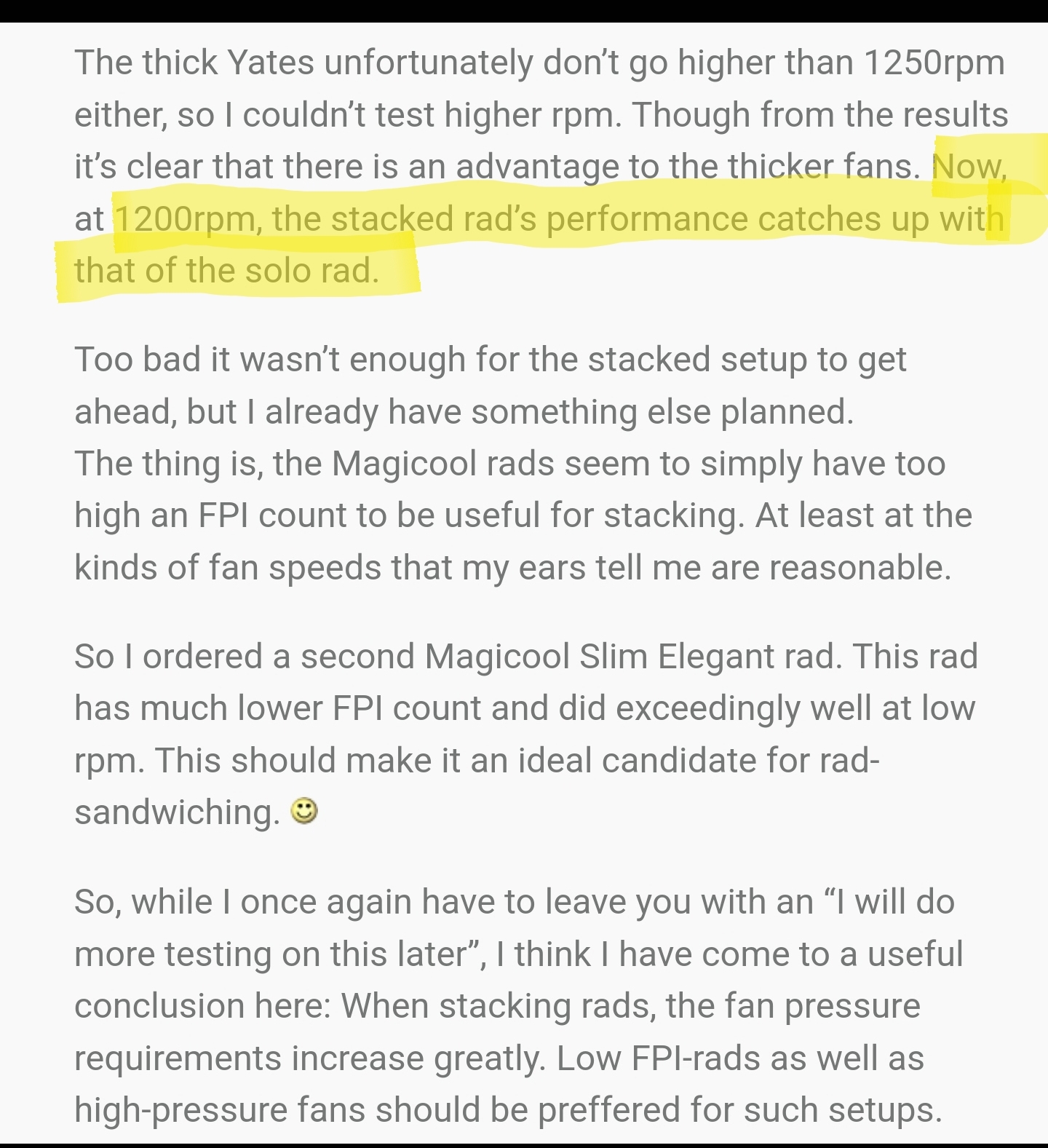

Second rad pic was my plan and unfortunately he didn't test that on top of only using 800-1200rpms fans for testing. I will be using Noctuas NF- A14 ippc 3k. I do want to use the flow he illustrates of going from the rear rad to the front rad.
It sounds like the findings from the martinsliquidlab test back up your plan to try with different fans. The conclusion really lays it out there and you do have a plan for high-pressure fans, so I think you should at least try it and let us know what happens!
I can't imagine your proposed configuration varying much at all from configuration #6.
However, if you're going to run those fans at their deafening max speed of 3,000 RPM, then you'll probably see much better results than any of these tests. Whether or not it ends up being better than simply running a single HWL GTR 420 in push/pull with those same fans at 3,000 RPM though... I wouldn't bet my money on it.

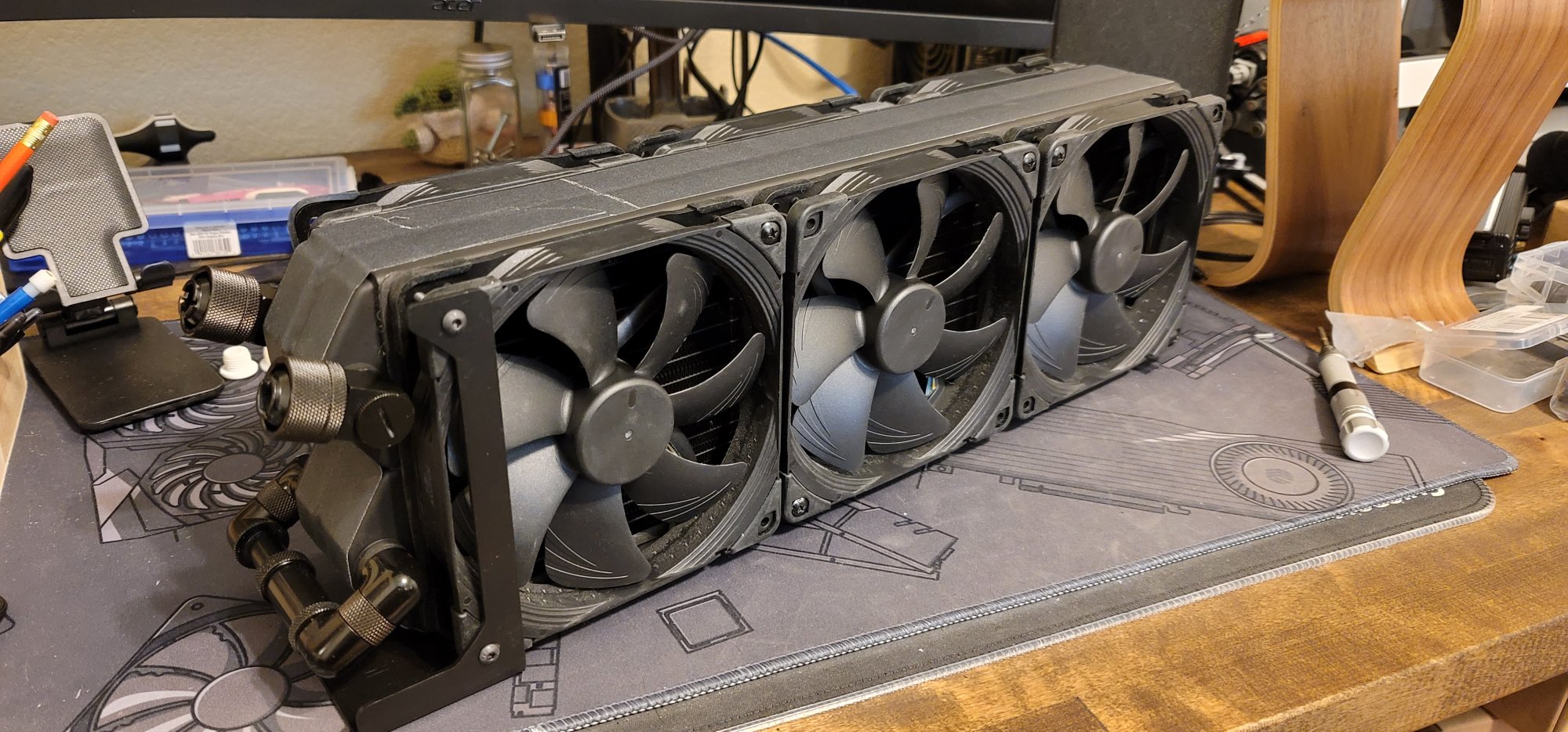

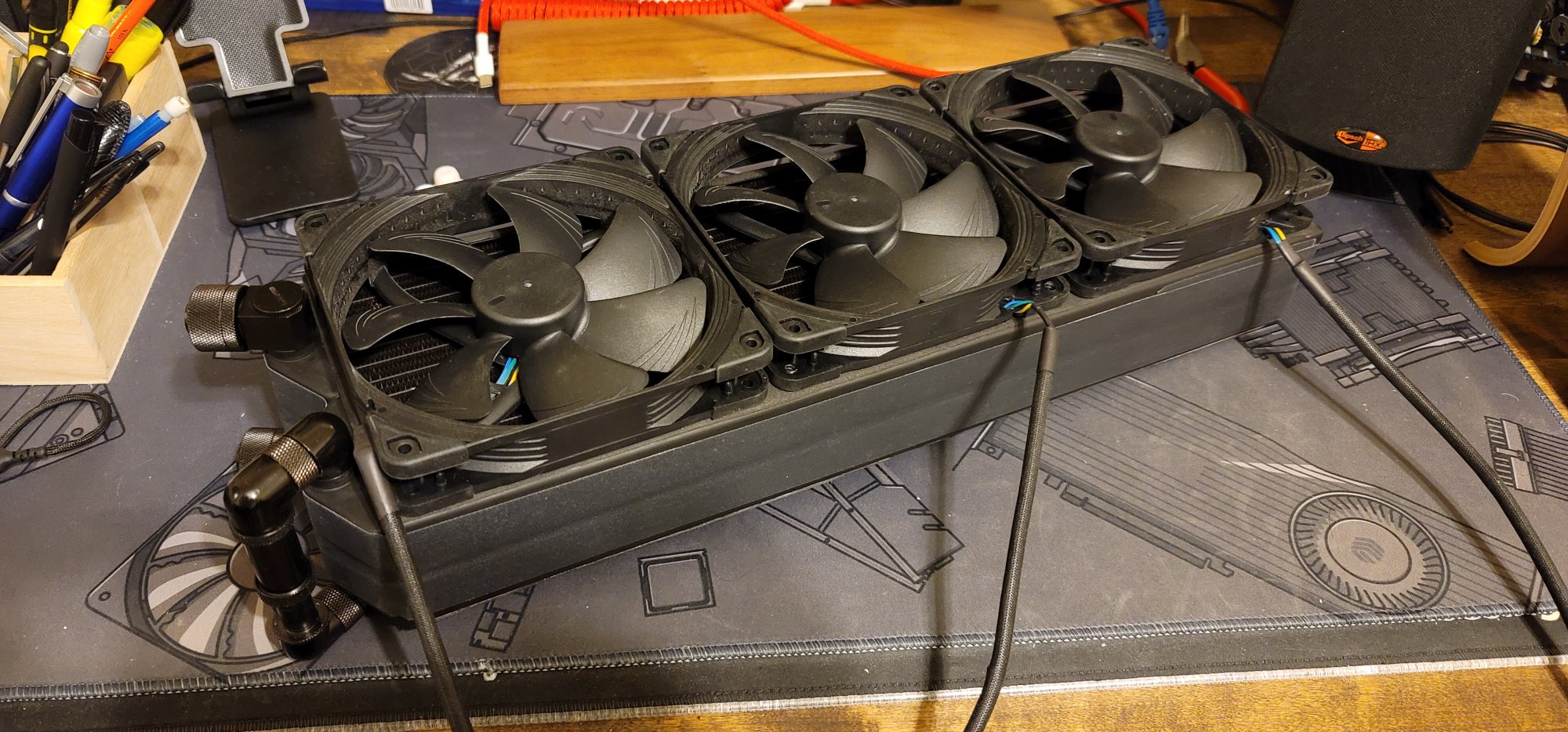

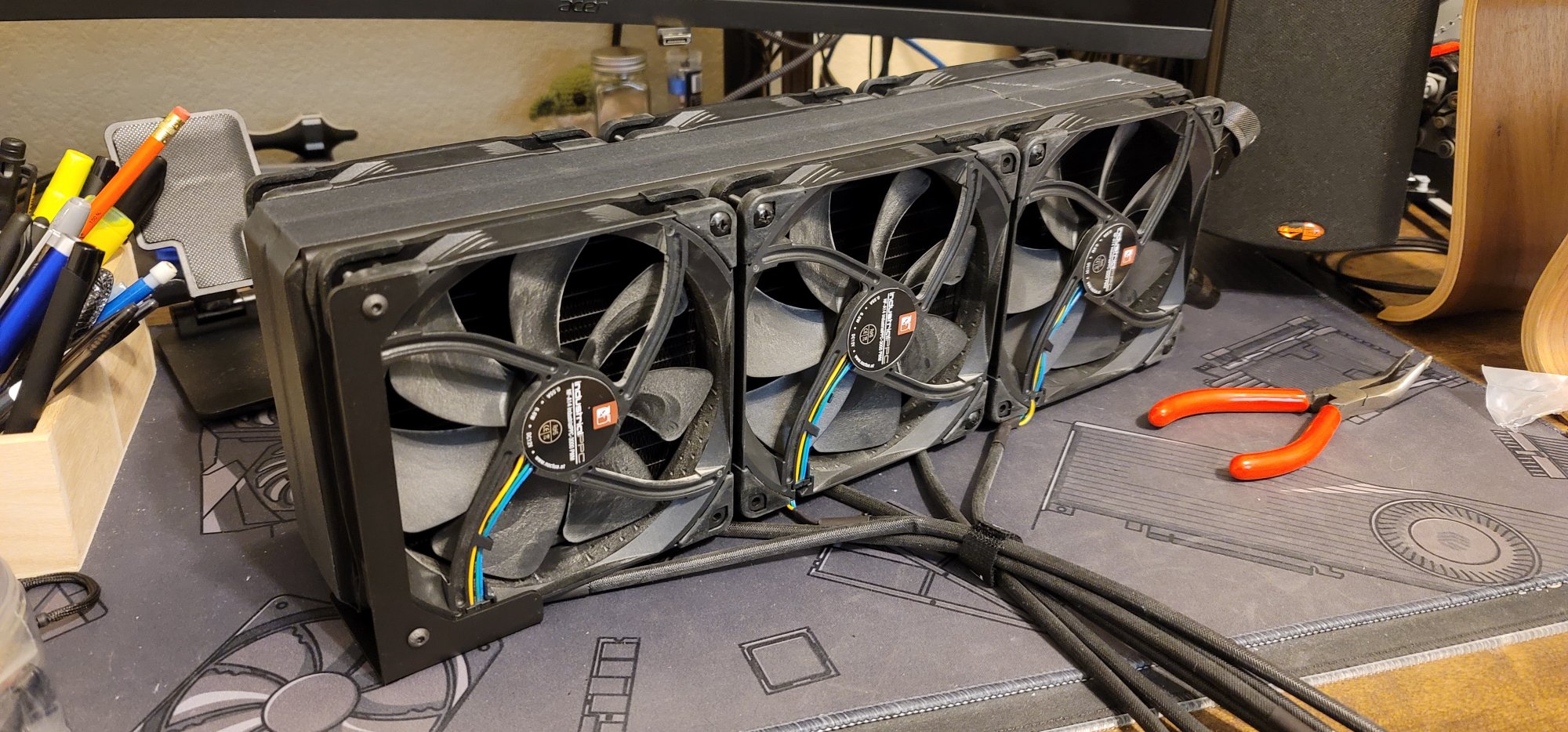

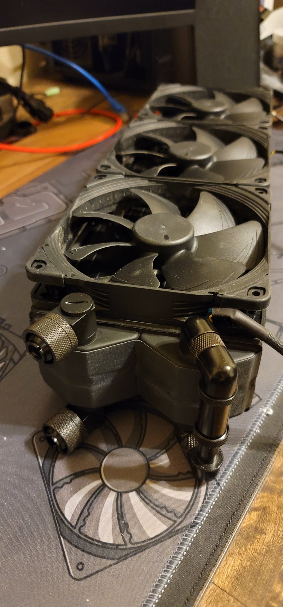

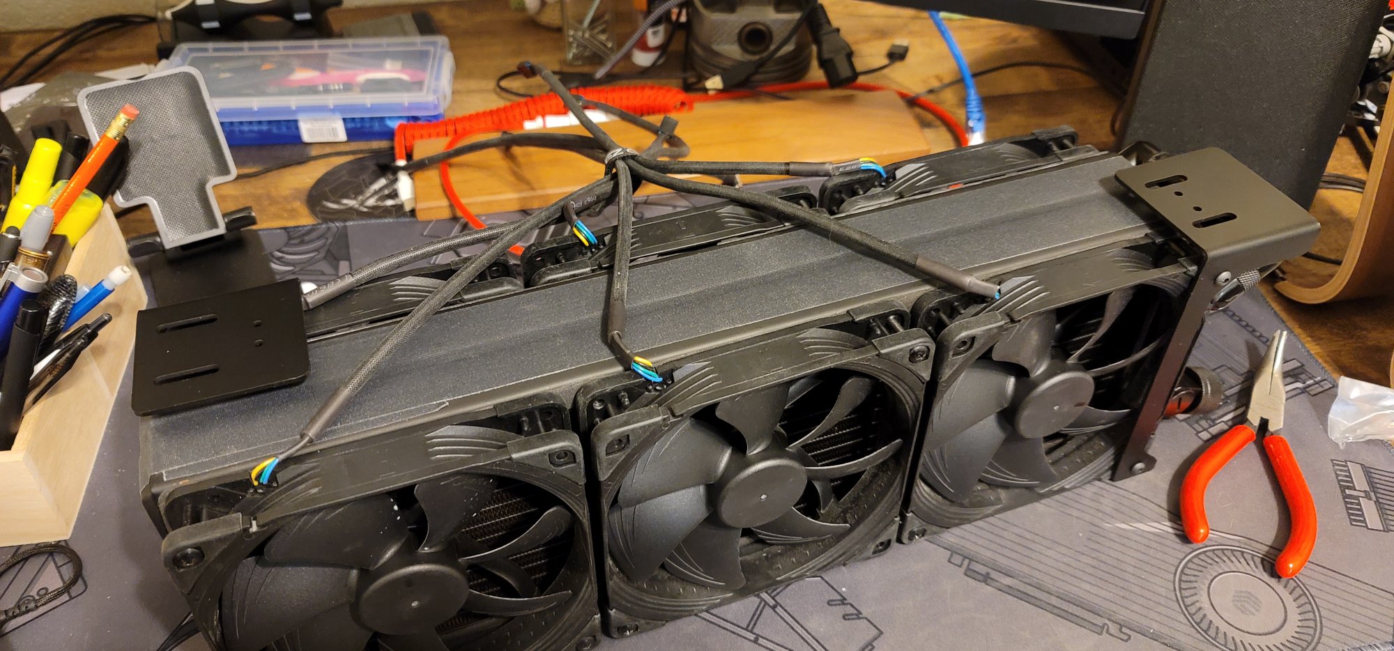

This is the progress I have on it so far. Missing the 3 other "Pull" fans. Just waiting on hardware that I ordered.
