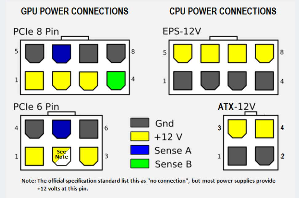

The cable you show is a 8 pin PCIe cable, not the motherboard cable. I see it's labeled CPU, but the pin interlocks don't match up, and the pin interlocks do match a PCIe 8pin. I don't know if they are pin compatible or not, but it looks like it was mislabeled from the factory maybe?
The D [] pins are an interlock to keep you from plugging in a cable backwards, or using the wrong cable. I'm sure you could get a hammer and cave man it in there anyway, but at least you'd realize your probably doing something that you shouldn't be doing.

The motherboard looks like it has the proper EPS-12V 8pin CPU pinout.
yea I never got that in any of my EVGA PSUs :/ They are just like the EPS-12v but then the last 4 are all D shapes. Do you know of where i can get one of those cables that is of quality?

I am pretty sure you can insert the split end into your motherboard without issue. I just inserted this cable into my PS into CPU2 and tested the voltages at every pin with a DVM at the split end. The +12V and GND were all correct.
Pin 4 and pin 7 are have rounded off corners on the bottom instead of square.

It's made that way so you can use the second half in another 4pin +12v socket if you motherboard had more than one.

It’s not a PCIe connector. Those only use split 6 pin and 2 pin plugs or single 8 pin plugs. This connector is two 4 pin plugs, one a standard ATX +12v keying, the other non standard keying that will fit into both ATX+12v and the left side of EPS+12v .If he tried to plug the combined connector into a GPU, it wouldn't fit as pin 6 would block.
