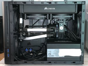

There is only so much dampening I am able to do for mine. It just seems like at certain speeds the pump hits a resonating frequency that transmits through the case. But the way my pump is mounted probably doesn't help either. I also never go above 90% with the pump speed because it will draw from the reservoir too fast, disturbing the very small air pocket that resides in there, breaking it up into micro bubbles, and sucking them through the loop. And that's even when using the provided tube insert they recommend using for such situations.
Due to my small case, my pump/reservoir is mounted horizontally. It is hanging off the underside of my radiator and its fans via EKWB's fan mount. This is an older picture from when I was first building it out, but its layout hasn't changed:

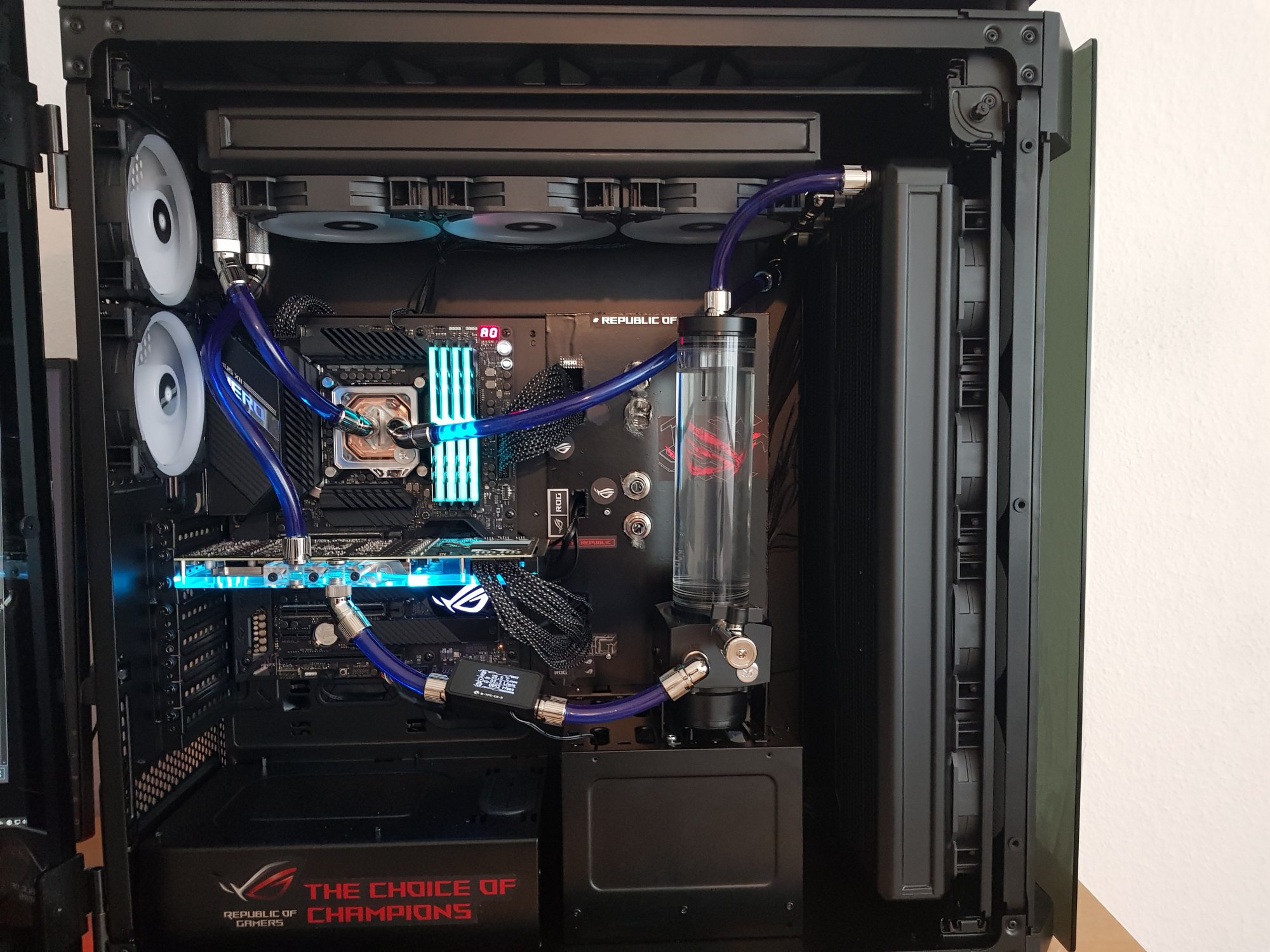

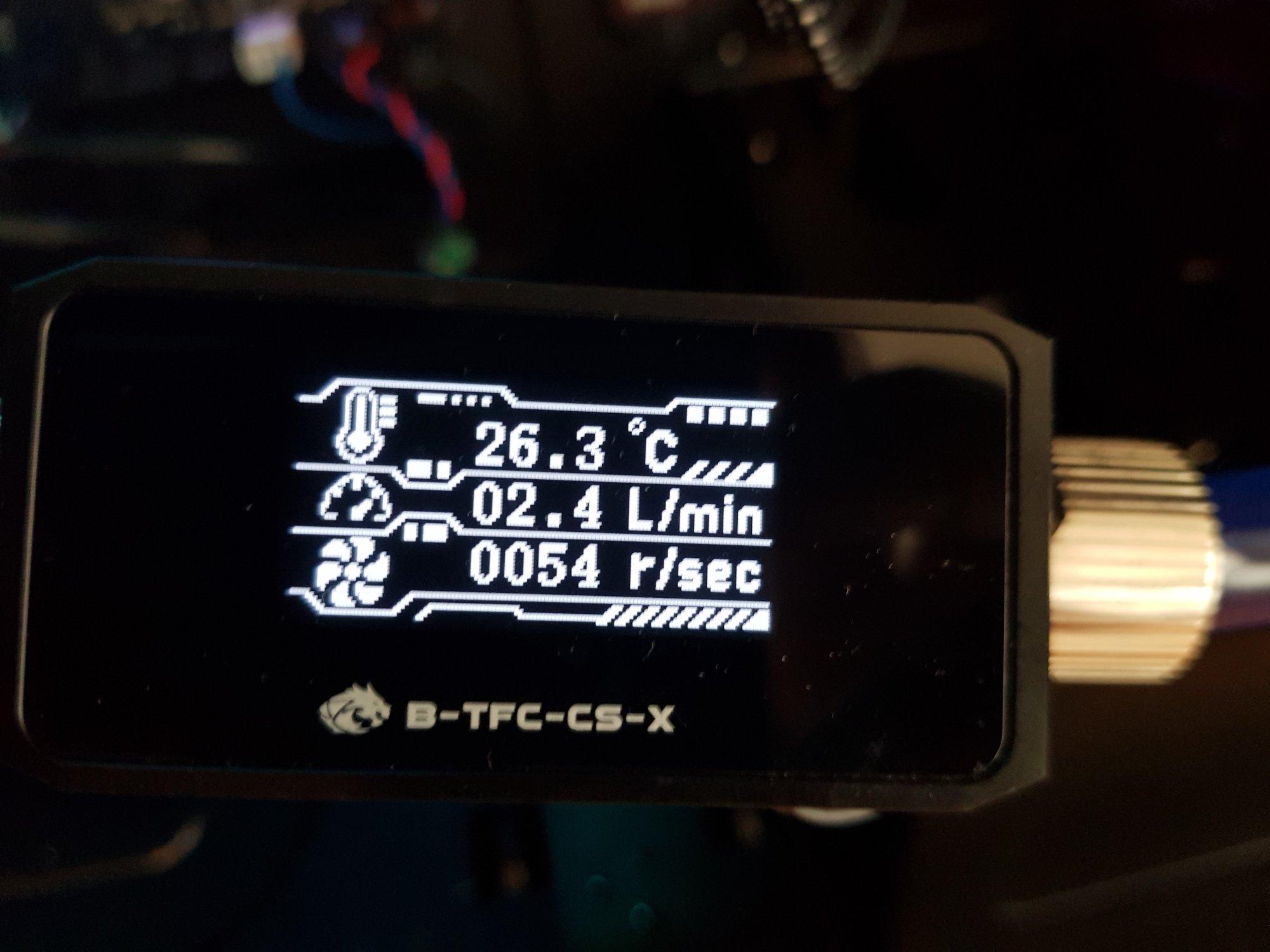

Hello everyone.
So, i have a temperature sensor which is plugged to one of the pump ports and also have a flow meter, i have noticed that the temps on both devices it doesn't match, when the temperature sensor reads let's say 30c water temp the flow meter reads lower temps something like 29.1c/29.2c or 29.3c, now i have a question: which temps should be more accurate?
The flow meter is installed right after the pump and so it wouldn't makes any sense to think that the temperature difference is because the temperature sensor is plugged to the pump.

Hello everyone.
The temp sensors aren't scientific grade, so they will have a fair amount of deviation in their specs. E.g. one of my temp sensors has an inaccuracy of +/- 0.3 at 28 degrees, which means that worst case you could get 0.6 degrees between a sensor showing high temps and another showing low temps in the same location. I mostly use my sensors as an indication and for controlling fan speed (radiator based on water and case fans based on exhaust temp). Temps should be marginally higher after the pump than in the res as long as the entire system is in stable state. If you read temps right after you started a thermal load and one of your sensors are at the inlet, then the outlet could be getting cooler water until the water in the res has been cycled/mixed with the hotter water. It could of course be high deviation in your sensors as well.

There’s a margin of error.
if its any consolation my water temp is at around 38 to 39c using the same bykski flow meter/temp monitor and a d5. Thats with a 6900xt, rx480 and 5900x mining/gaming/farming chia. Flow rate is approx 3.2lpm. Rads are a 420 and 240.

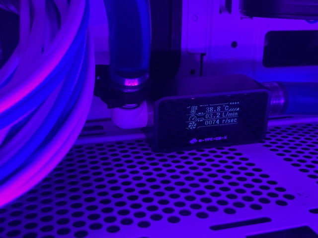

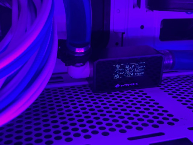

I have the same flow meter and it has confused me with the flow readings. They are roughly 10% of what they should be using a D5 pump. My EK pump at 3800RPM reads a flow rate of 2.0 L/min when it should be 20 L/min with no restrictions. I have only 2 rads and a CPU block so I would think it would be at least 15 or so. This flow meter is also supposed to work or 12V but when I got mine the Molex plug is wired to the 5V side of the plug. My loop is reading 22.1C for coolant temp on the device and 23.2C on the coolant temp sensor attached to a pump port so flow seems pretty darn good, ambient temp using a thermal probe is 19C average (measured at the air intake area of the two rads).

Hello everyone.
My temp sensor on my flow port is about 1C higher than the flow meter. I just figure since the sensor is right on the pump that maybe the pump body is causing slight temp increase, my flow meter is after the coolant has passed through one of my 360 rads and on its way to the CPU block.
What waterblock are you using?
You're not going to get anywhere near 20L/min in an actual loop. This is with a xspc raystorm pro, bykski block on a 6900xt, maze 4 gpu block on a rx480 and two rads.

Couldn't find anything regarding how restrictive this block is, how are your temps? This is a brand new loop?
Temps are great. Does not break the 70 C mark unless I am doing something like running benchmarks. Coolant sticks around 22-23C all day long. Although I have not added my 2080 Super to the loop yet and that is just the 5900X running pretty much unleashed at I have the EDC limit set to 200A and using Curve Optimizer to get peak boost on all cores. I do not normally run HWInfo64 all day so as of right now the peak temp on CCD1 has been 59C and CCD2 has been 51.8. I have not gamed at all yet today though but from the last time I ran HWInfo and gamed it may have topped out at 66C. Loop is new as of a few weeks or so ago, I changed cases about a month ago and did a temp loop with rubber tubing until I could get some more hard tubing. I did that a few weeks ago and added the flow meter. Temps are pretty much the same either way since I got the case and added the second 360 rad. They were fine with the one but I had a Corsair Crystal 570X case so the airflow to the rad, in the front, was restricted with the front glass panel on. With the Corsair 5000X RGB case it does have a front glass panel but the side one is just a filter so less restriction, I am waiting for Corsair to get the 5000 AirFlow case front panel in stock.

Stated flow rate for any pump, is based on literally pushing fluid though a tube. No blocks, rads etc, same with the head pressure.
You will never get the max flow rate, regardless how accurate the flow meter is, you will probably realistically never hit the lower stated number, with even a basic setup.
All you can do is minimize restriction. But even that has minimal returns.
Jamie Marsala
Mar 9, 2016
309
Understood. I just wanted to make sure the numbers were what others may see and I see two people on here seem to get the same numbers. I really like it for the looks and the ability to easily see what the coolant temp is. I can see my coolant is flowing in the reservoir so I know it is pumping.
