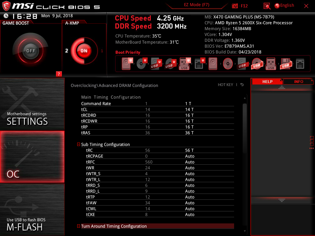

  10. gerardfraser
    gerardfraser Gawd
    Messages:
    619
    Joined:
    Feb 23, 2009
    No ,I built a Ryzen system with intel approved ram and I can run with tighter timings and overclock it just fine.Ram 3200 and has never had a problem running 3200.
    I have AMD ram in a intel system and I had to up the voltage by 0.05 to get working rock solid.
    So I suggest to OP set ram to 1.4 in BIOS and see how it goes.You can always lower voltage.
    EDIT:Added screen of timings.Op try 16/18/18/18

    Thanks for the information,yes I agree easier to say QVL. I was trying to help,I do not have QVL but I got lucky and it worked. Thaiphoon burner says Hynix CL16 same as samsung B die

    Aug 22, 2012
    Not really true, MSI finally figured their shit out, I'm running 3333mhz on Hynix sticks, which were stuck at 2933 since launch lol. My cheap ass Tomahawk is giving Biostar boards of the early 2000s a run for their money as far as best oc boards for dirt cheap...
