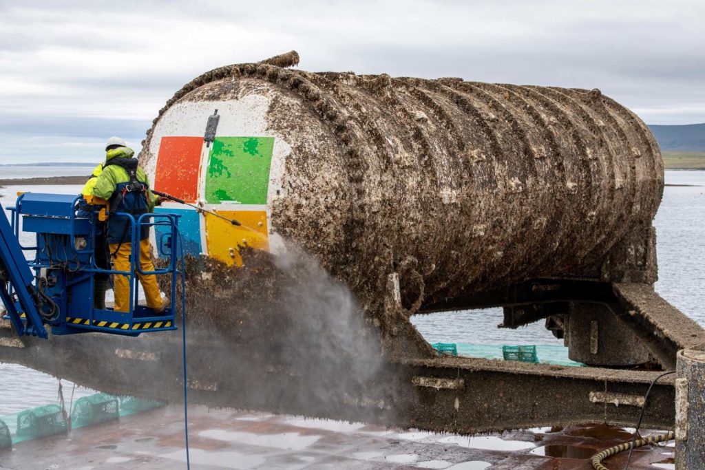

I don't know.... Microsoft's Project Natick was a resounding success, and that stuck a datacenter in a sealed container under the ocean.

The core maintenance philosophy of Project Natick was to eliminate on-site physical maintenance entirely due to the difficulty of accessing a submerged data center.
  • "Lights-out" operation: The data centers were sealed in a dry nitrogen atmosphere to prevent corrosion and were designed to run autonomously.
  • Fail-in-place: Instead of repairing or replacing components as they failed (which is standard practice in land-based data centers), the system was designed with enough redundancy that failed servers or disks were simply taken offline, and operations continued without disruption.
  • Periodic overhaul: The entire data center unit was designed to be retrieved from the seafloor every five years, at which point all servers would be swapped out and recycled, and the module redeployed.
What Microsoft discovered at the end of the project was that they experienced 1/8'th the failure rate of hardware in that environment that they expected based on similar hardware failure rates in their traditional datacenters.
Solar power works exceptionally well in low Earth orbit, and advancements in satellite tech have made high-speed speed low-latency networking a cheap thing to do in that environment. StarLink works by taking multiple small dishes and simulating one large one through some software black magic. It can be scaled up incredibly well, especially if you aren't worried about the physical footprint of the ground unit.
Microsoft already operates Datacenters that cost it upwards of $1.3B a year to operate, and that is utilizing sweetheart electrical deals and exemptions on land taxes; if those deals end, that number could easily double, at which point they are looking at numbers rivaling the International Space Station in terms of annual upkeep.
So if you are looking to host a large AI infrastructure, but you don't have the same level of Government in's that the likes of Microsoft and Alphabet do, then you are in for a very expensive world of hurt.
Project Natick proved that it could work in concept, and Solar advancements have made for lighter, more efficient panels, which could greatly assist in power delivery.

It didn't fail....
Project Natick was a technical success, proving underwater data centers are reliable, sustainable, and efficient, with lower failure rates than land-based ones due to constant cool temperatures and nitrogen. However, Microsoft ended the project in 2024, deciding it wasn't commercially viable, pivoting to apply its lessons in robotics and sustainable infrastructure to other areas, even as other companies explore similar concepts.
Successes of Project Natick:
High Reliability: Servers failed less often underwater (1 in 8) than on land (8 in 135) due to stable temperatures and inert gas (nitrogen), avoiding oxygen's corrosive effects.
Energy Efficiency: The cold ocean water provided natural cooling, reducing the energy needed for climate control.
Sustainability: The test pods used renewable energy (Orkney's wind/solar) and were designed to function without human intervention, reducing land use.
Feasibility Proven: It demonstrated that deploying and operating data centers underwater is possible, even in harsh conditions.

i know it’s a “technical” success
but ocean-based data centers definitely didn’t kick off a mass market trend or adoption
it’s a genuine failure even by your own quote, “Operational Challenges: While technically sound, the cost and logistical hurdles of building, deploying, and retrieving these massive underwater units outweighed the benefits for Microsoft.
Shift in Focus: Microsoft is now exploring new tech like advanced robotics for land-based data centers and novel power sources, applying Natick's insights to broader sustainability goals.”

I'm not saying you can't make a (small) datacenter in space; or underwater. I'm just saying it's not a good idea, because it makes everything hard and costly. Microsoft doesn't run any underwater servers, because it doesn't make sense to do it beyond research, even though you can.
Space datacenter for research --- sure; constraints drive creativity, and that's good for things. Space datacenter for serving actually terrestrial needs? No, there's no good reason. Maybe you could stuff some storage and host CDN nodes in starlink, although you're probably going to figure out how to get the top CDNs to collaborate on a shared system cause you don't really want one box from each major provider.
