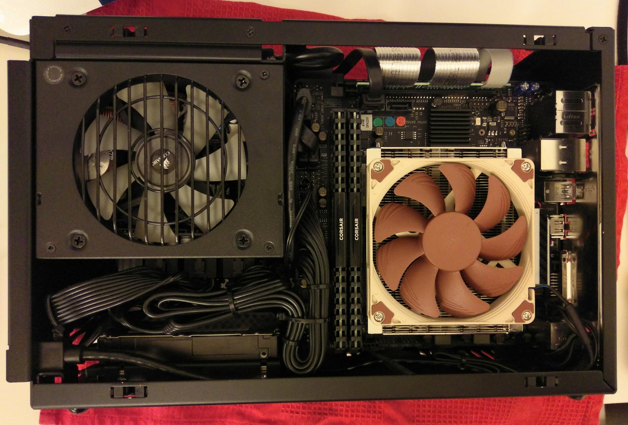

So a quick 20min prime95 run, at 1.15am :confused:, gave me 72 degrees Celsius. That's at the default 3.2 on all cores. There is no temperature offset on my 1700. That is immediately after installing, I expect temperatures to drop a bit once the tim spreads/settles a bit. Also I did a crazy tim application method which may not be optimal... I am pretty happy, it is a real no fuss solution, I'm sure I could drop the temps slightly with a duct too. Based on continued research, when gaming at 1440p or in any GPU bound scenario I see no benefit going with an i7. I am really happy with this setup!:)

Running prime95 now, total system is pulling 125watts at the wall.... System idles at 50watts. We will see where the temperature stabilises...
It stabilised at 68 degrees at 2500rpm after not long, I ran it for over two hours to confirm it wasn't slowly increasing. Ambient temperature was 23 degrees. I will do a final test and add it to the Google spreadsheet soon. Very happy overall :)

No problem, yea I think the Ryzen chips are a great fit for the Dan case. I suspect that the L9a would even cope with a 1800x, hopefully someone will try it! I suppose I could overclock too simulate an 1800x but I I want to do some gaming now that my system is setup nicely!
