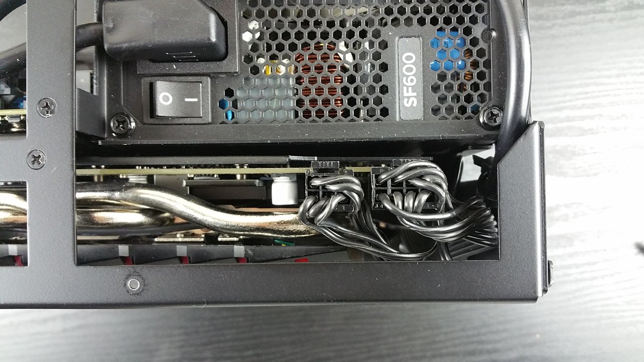

The MSI Gaming GTX1070 fits perfectly the A4.
(I presume the 1080 will too and especially the 1080ti because they came back with the receased part for the pci-e plugs but of course you will not put the side panel anymore because it is too wide and have a muscle pitbull stance :p )
No need to remove the side panel push in clip. Only some convincing for the PSU cables. To hold them into place i used zip ties and once fixed took 'em off. The top/front panel fit perfectly.
*Side-upgraded from a 980ti to the 1070 even more quiet pourpouses and low temps and more efficiency. Plus the newer arhitecture and the extra 2 GB of Vram plus sold it for x and payed the same for the new one*

Thanks ! For now they are good on the video card's end.
But you got me thinking. Maybe i can do that to the PSU so i can increase the space in between it and the fan from the AIO.
Will companies that do custom cables will tackle angled connectors? I mean all that exist the PSU?
I don't think any company will bother with 90° Molex Jr. connectors. I also don't know of any official 90° Molex Jr. connectors in the first place, so your only way would be to follow the earlier posted German thread.
