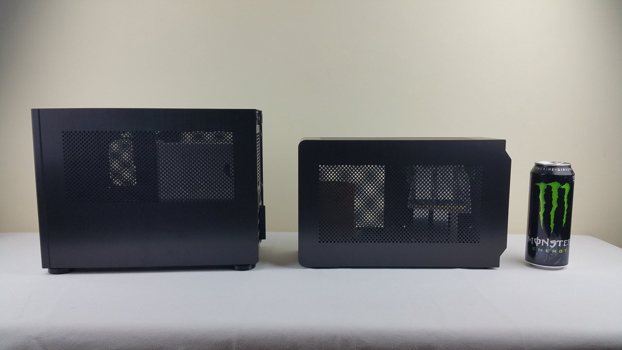

DAN A4-SFX: The smallest gaming case in the world
