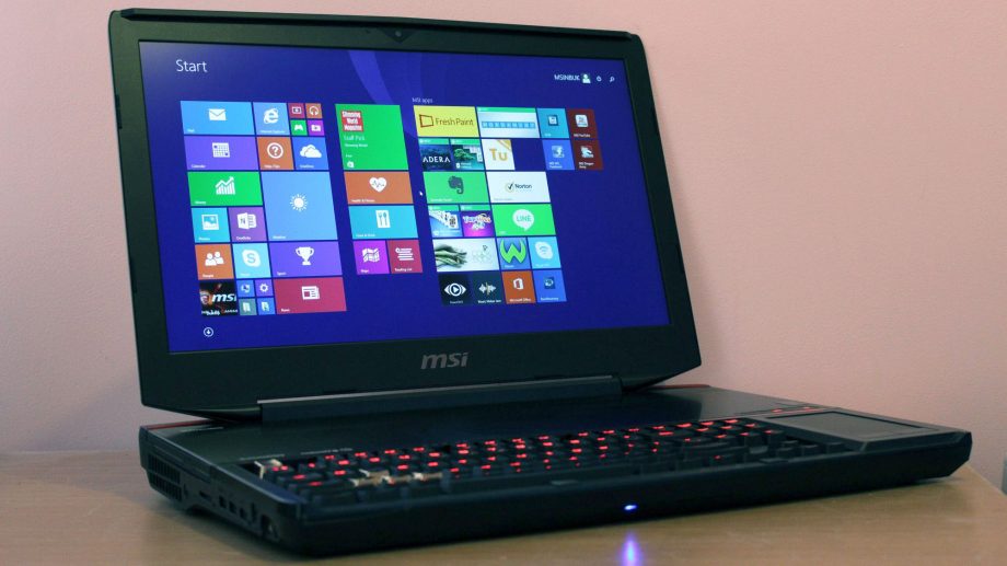

Thanks for making this thread. I kind of gave up on looking for something for mine. It's a MSI GT80 2QE:
Overall a pretty neat machine and still very comparable to many desktops. Two Nvme raids(one pair of Intel SSD's and the other Samsung 850's, and a hybrid drive. Two 980m's in SLI that still can push 60 fps in 1080p(18.4" screen) for modern games that, cough-cough still support SLI or I can find bits for. Upgraded to 32GB 2133mhz. Biggest problem is of course heat. Temps on the CPU and GPU's are 70-80c with fans maxed! When fans are maxed this thing is ridiculously loud too.
Never knew about those kind of other exhaust coolers before. Interesting but I'd be more interested in something that creates cool air to feed into the bottom. Looked at many laptop coolers but I don't believe simply pushing more air is the answer. Hoping someone chimes in with something that can go that extra step.
