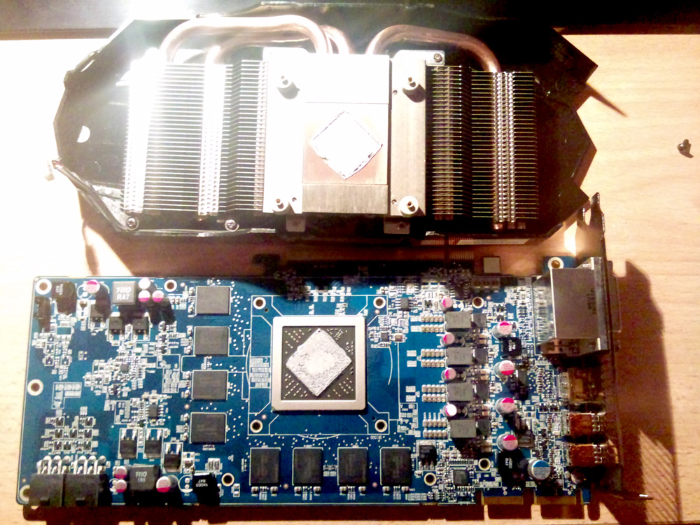

Yeah its the 6870 pcb. I have two Saphire 6950 2gb rev2 (11188-00-40r) and their design its the same. Futhermore the new Xtreme version of the 5850 also uses the 6870 pcb.
attachment.php
