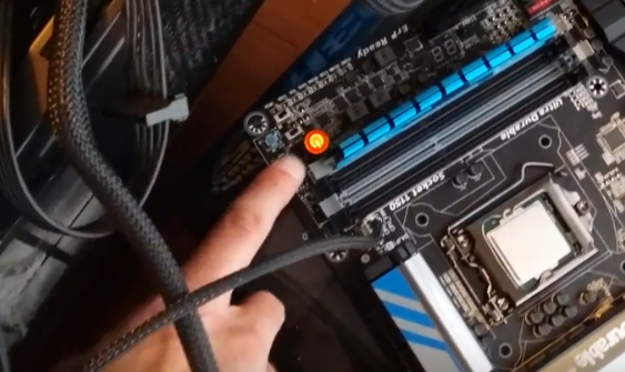

Unless i'm blind, I don't see it: Gigabyte Z87X-D3H
should be the orange? power button in the upper right near the ram, it doubles as the power led.
stole this from a yt vid:
Nope, It's not there. Maybe it would help if I mentioned the revision. Rev 1.1
But I'm pretty sure there's no light because I'm looking at the mobo right now and I don't see one.

I looked at the manual for your motherboard and it indeed does not have a power LED on it. So either follow the advice of pendragon1 or wait a couple minutes after turning off the PSU to let the caps drain.
Watch this video. Maybe it will relieve some of your fears. And/or give you a good laugh...
oops forgot to address the led. yeah I dont know what rev that vid had so its possible it changed. when you plug the system in but dont power it up do you see any leds light up on the mobo?
