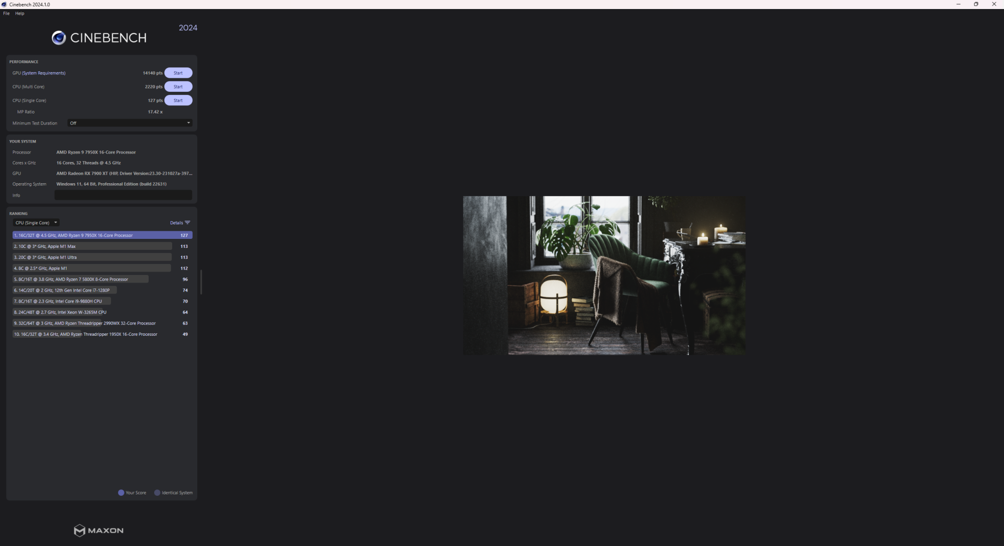

I weas curious ..so I gave it a go
It appears that the 4000 series RTX GPU's just stomp 7000 series GPU's in this particular benchmark (7900XT)

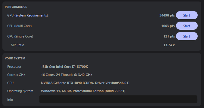

Finally got Cinebench 2024 to run on my main PC. I had to lower RAM speed to 6200MT/s from 6400MT/s to get the CPU tests to finish and increase the voltage of the 4090 from 950mV to 960mV to stop the GPU test CTDs. I also disabled WIndows 11 Core Isolation for good measure. This benchmark is very sensitive. I've never encountered any stability issues with other benchmarks/stress tests as well as with gaming/daily use with the previous settings.
Was trying to improve my score.. not really much I can do at this point except replace hardware :D
