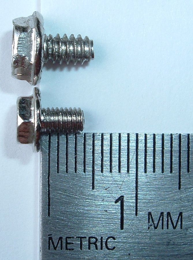

^^^ ahhh ... good point about correct threads. 6-32 and 4-40 are common and not usually mistaken for each other. However, standoffs sometimes come in M3 threads which is closer to same diameter as 6-32 but finer pitch thread. Easy to strip if mixed.
Parts are often packaged wrong. This is why one should always hand test all hardware for fitment before applying tools.

And I am still betting you mixed 6-32 and M3 threads somehow. Would not be the first, or last.
