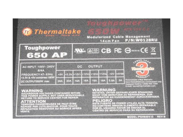

I am having a hard time trying to figure out power supplies. I thought that combining the +12v rails (On PSU's that had multiple ones) would give the amperage rating you need to know on video cards. I was wrong.
I was told that instead you need to find the number showing the max. wattage between the +12v rails and divide that by 12 to get the amperage rating.
However, lets say you're browsing power supplies in a retail store and you come across... this...
http://c1.neweggimages.com/NeweggImage/productimage/17-153-040-05.jpg
It doesn't show the combined wattage of the +12v rails anywhere, so how are you supposed to calculate this? What's the formula?
AFAIK, there's no formula for those cases where there is no info whatsoever about the total amperage on the +12V rail.
If the total combined or max wattage can't be found on the power supply, check the manufacturer's site page for that PSU for that info. If the manufacturer doesn't provide that information, it's generally a good sign for you to drop that power supply from consideration.
In this case, on Thermaltake's own website, it shows that there is 52A on the +12V rail for that Toughpower 650W:
http://www.thermaltakeusa.com/Category.aspx?C=1264
See the +12V column?
in DC: Power = Voltage * Amperage, but there's no formula for information that's not given. Fundamentally each 12V rail pulls from the same bridge rectifier, and that bridge rectifier, according to thermaltake, will output a maximum of 52A half-cycle average. But they shouldn't expect you to know that.
