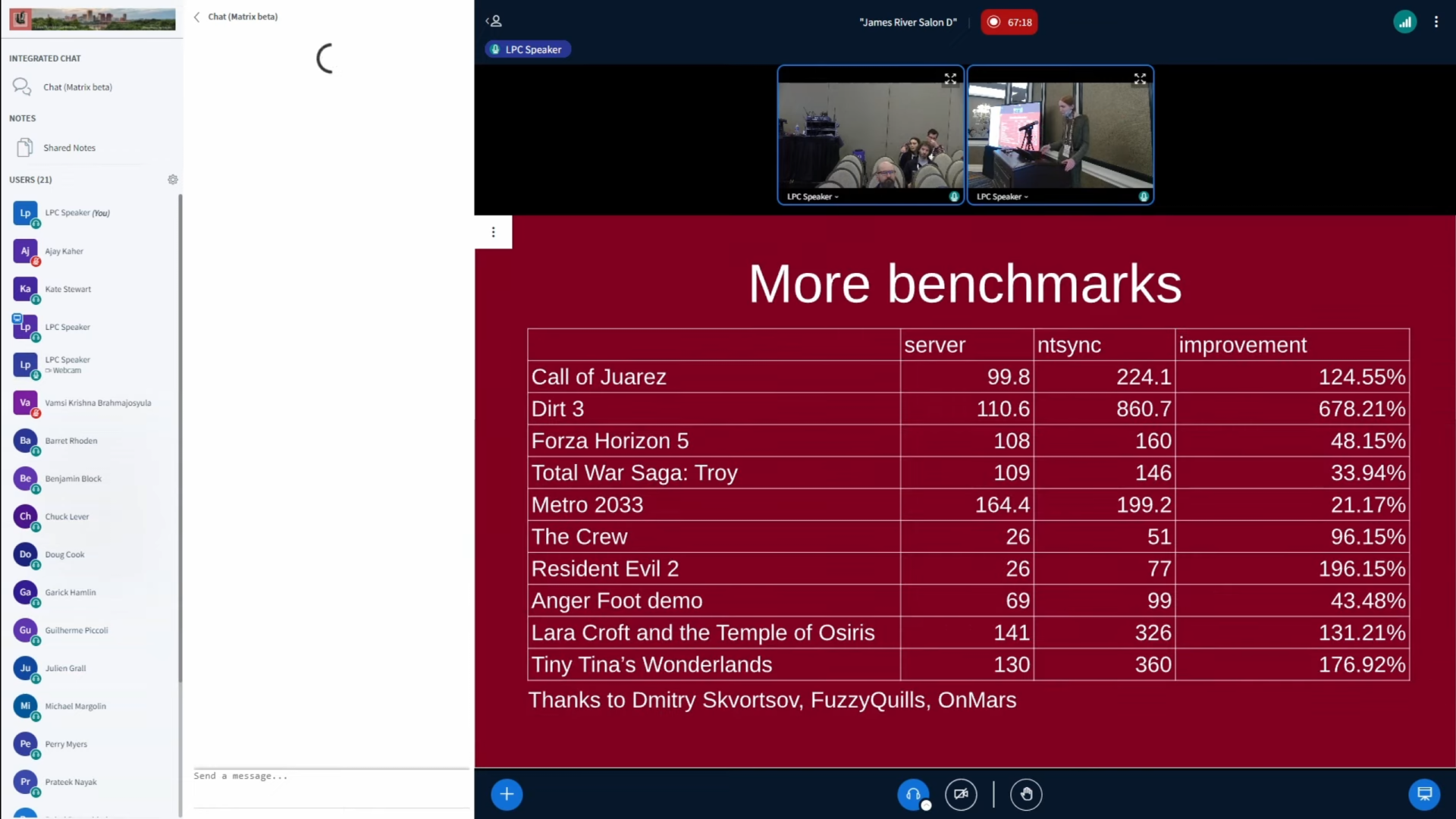

NTSync 100% improves performance. Compared to Fsync its 0-5% depending on the title in question. It for sure will be better for games with 0.1% and 1% low dips. For wine without Fsync it can be as much as 150% as wine right now doesn't have a sync.
NTsync is the work of Zeb Figura from Code weavers. This is a kernel side implementation not a user space one like Fsync. The screen is from her talk and this is vs wine not proton. NTSync is a big improvement, its now a kernel driver... its going to lead to improvements in a lot of titles. It should for sure help in less popular older games that haven't had Valve going over and optimizing for them.
View: https://www.youtube.com/watch?v=NjU4nyWyhU8

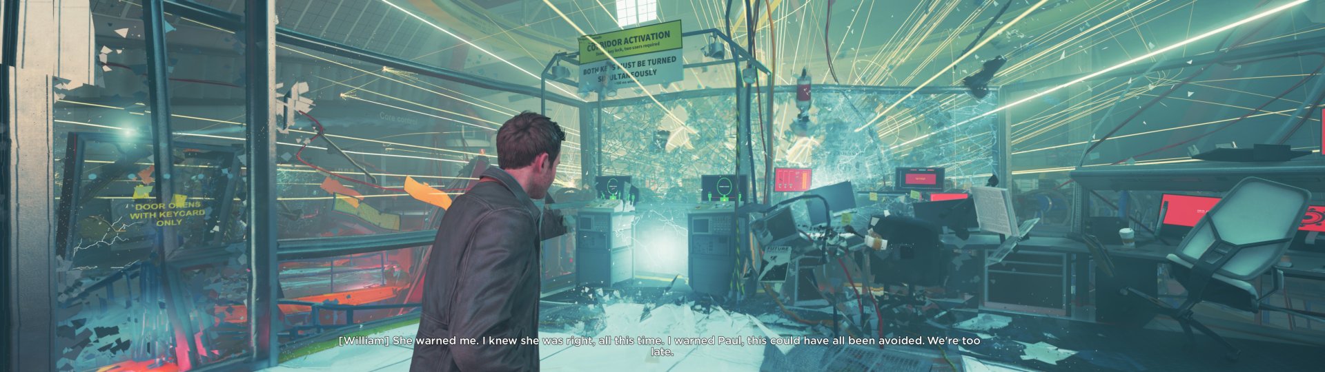

I tested Quantum Break last night & it ran really well, though I hit the lame 21:9 max resolution hardlimit. I'll be testing out the modified exe tonight for my 32:9 monitor & see how the game flows with FPS & frame time.
Running & looking good. Seems butter smooth with the current kernel & Mesa drivers.
