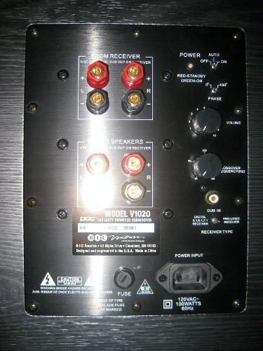

The BIC V1020 is an interesting suggestion, and looks to be a better value for the money, with the overall cost being within a few dollars of the Monoprice 12". However (and please excuse my noobness as I am still learning), I searched and saw the amplifier section and am confused on the inputs and outputs. The ports on the back do not look like RCA connectors (at least I don't think they are :p), so how do I connect this subwoofer to my setup? Keep in mind, I do not have a receiver.

You connect it like any other with a subwoofer cable :p It has the "rca"

That doesnt help him exactly.
The picture here shows only a mono line-level RCA input and stereo high-level speaker inputs. You can't use the high-level speaker inputs because your source is line-level from your DAC.
OP, since you have a DAC that outputs a line-level signal and also active speakers that are full-range here is what I would do.
Simply split the RCA outputs from the DAC into your subwoofer and your speakers. You will need a subwoofer that has line-level stereo RCA inputs or else you will only get bass from one channel.
You will then have to play with the crossover knob on the subwoofer (make sure it has one of these too). You need to cut off the top range of the subwoofer to a reasonable level. Basically wherever your speakers start to really play back frequencies well. Maybe around 80-100Hz.

Thank you for the detailed reply! :) Judging from your response, it looks like none of the BIC's mentioned above would work with my setup, which is a shame since the reviews are very favorable. If that is the case, it looks like the Monoprice 12" is all that is left since it coincidentally has RCA inputs and outputs, unless there are other good choices for $200 or less.
Does that sound about right?
Correct, anything that has a Red and a White (stereo) Line-In as well as a crossover knob (like the Monoprice 12"). Though the crossover knob isnt strictly necessary, it's just highly recommended for optmal sound and subwoofer performance.
