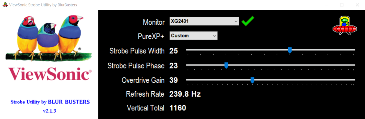

The trick is giving advanced users the choice to configure. Any vendor monitor will usually be more likely to be pass Blur Busters Approved if they support an optional strobe utility for an optional "Custom" strobe setting, with lots of adjustment settings, with additional adjustment settings for VRR strobe (adjusting the flicker-vs-singlestrobe tradeoffs). This applies to both fixed-Hz strobe and variable-Hz strobe: Letting users tweak VRR strobe in the future.
(Note for advanced users: Vertical Total reduces input lag via the Quick Frame Transport effect, while simultaneously giving more time for LCD GtG, reducing strobe crosstalk. Upcoming versions will autoconfigure Vertical Total. VT4500 for 60Hz is supported, and VT2500 for 120Hz is supported.)

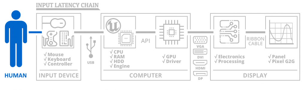

We know professional players in esports don’t always use strobing. However, it can be strategic for certain games. Where motion blur reduction (via strobing) reduce human reaction time by more than 10ms (due to less motion blur fog slowing your reaction in more arena-style games). Human reaction time savings in arena-style games can be significantly greater than any tiny (~2ms) increases in input lag caused by strobing. Some champs are smart enough to optimize for total human-to-pixels lag.
The human is an input lag component too, so one is optimizing for the ENTIRE lag chain from brain-to-pixels, not just button-to-pixels. Including your brain’s reaction time, reduced by less motion blur.
