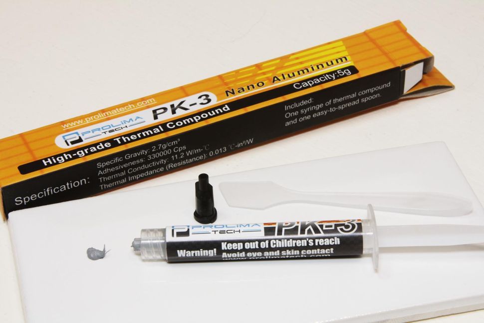

Pk3 is really good but i dont remember what the rating is, i think its 3 or 5 years but im guessing. Dbl checked the website and found no mention. I bought mine from Amazon two years ago ($17) but its been oos for at least 8 or 9 months. No idea why it hasnt been restocked or why its become so hard to find.
Found it at frozencpu.com for roughly $21 5g tube.
Edit- when i tested mx-5 it was only a degree or two off of pk3.

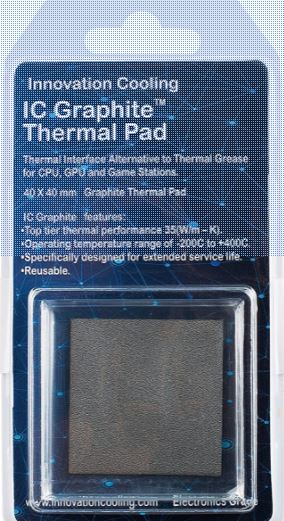

best long lasting is "High end thermal pads". it wont match liquid medal but will last forever or the life of the setup
Price:$12.95
They have a new kind, which I will receive this week. It's not reusable, but is supposed to compress/conform better.
I have an r9 fury I'm going to try it on. (the hbm is not flat enough to use paste on)
non reusable is a no go to me......reusable is good...to me its half the point of using pads. When i rip my cooler off once a year and put it in the dishwasher and its time to put back on i dont have to look for any paste or pads. My cooler has a stupide convex base instead of a true flat one is another reason i went pad this go round. strange as it is i have heard of people doubling the pads up in certain conditions.
I'm using that thermal pad on 2 rigs - and no problems at all. I switched after I had a mishap with an old 2700k rig where the CPU twisted right off. Not going to repeat that mistake ever again.
Since I'm not OC'ing - stability is key ere and the pads do just that. Remove and swap CPUs without any incident and can reuse the pad again too.
