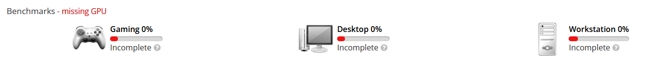

Dear community,
I tried to benchmark my Asus configuration.
I have:
Ryzen 7 3700x
GTX 1070ti
Ram Corsair 4*8 Go
Samsung 970 Evo+
I got following results:
There is apparently a problem with the GPU and the RAM in this bechmark. However I have no problem to play games.

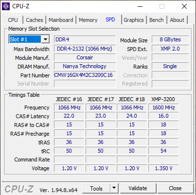

Ok, thanks. How do I check if the 1.4V is better than the 1.35V without using userbenchmark?
I made a CPU-Z and have following results, it seams that the RAM sticks have some different characteristics, even if they had the same reference where I bought it:
Slot 1&2: Nanya ranks "single"
Slot 3&4: SK Hynix ranks "dual"
Also I get 1066 MHz which is even less than the half of 3200 (ie 1600)
Does anyone know what it means and if that influences my benchmark? (I suppose it is better to get the same information on Slot1&3 and then 2&4)

Based on your screen shots, your DOCP isn't active. You're running at the JEDEC default 1066 (DDR4 2133). Yes, it would influence your benchmark if it were working, but shouldn't influence the fact that it doesn't complete it.
Also, I think you'd actually want to separate the modules so you'd have the Nanya in slots 1/3 and the Hynix in 2/4 because of the difference in single vs dual ranks. This is the problem with Corsair. You buy the same model memory and get two different ICCs and configurations. Single vs. dual rank is just the configuration of the chips on the individual sticks. I'm guessing the Hynix ones are older. I guess ideally you'd want to run 4xsingle rank or 2xdual rank, and not mix and match, but here we are because Corsair is useless with their naming schemes. I would make sure they are paired together correctly which they probably aren't.

Now I switched stick 2&3. So I have the same information slot1=slot3=SK and slot2=slot4=Nanya in CPU-Z.
However the references directly written on the sticks are different! I have slot1=slot2=ver8.31 and slot3=slot4=ver5.22
:cry:
Still 2132 MHz..

DOCP is selected and "accepted", the PC boots normaly, but looking at the CPU-Z I notice that the frequency is only at 2132 MHz
kirbyrj
Feb 1, 2005
29,730
https://www.asus.com/us/support/FAQ/1042256
Try loading defaults and then applying again. What speed does it say under the memory tab of CPU-Z?
For example, under the SPD tab mine says DDR4 2400, but under the Memory tab it tells me the correct speed of 1800Mhz (DDR4 3600) along with my current timings.

For all we know though, it is working...what does it say under the memory tab of CPU-Z?
kirbyrj
Feb 1, 2005
29,730
So it is running at 3200Mhz...
I would just add in the other sticks and be done. Just remember since you are running "mismatched" sticks, keep the same versions in slots 1/3 and 2/4.

Some results tend to give a 3200 MHz (memory section, windows 10), and some not (SPD section, userbenchmark)
Hard to know if it really works as it should
pendragon1
Extremely [H]
Oct 7, 2000
39,893
dont worry about cpuz showing 2133 in that box, mine does too even though the bios and windows show the proper 3600(oc'd from 3400). they are just showing the base speed. since you are trying to run 4 sticks, make sure your vsoc/vdsoc/vddrsoc(whatever your bios calls it) is at ~1.1v. i missed that you have 4x8 and with all slots filled you usually need to make sure its bumped up too.
