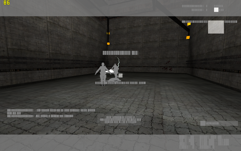

Playin CS:S and all of a sudden it freezes. Then everything turns a mixed color of yellow and blue. Then freezes again and does this:
Anyone got anything near an explanation? My last MSI 8500GT done this before it croaked and wouldn't do 3D anymore.

Noticed something new. If I open anything 3d (game/nvidia control panel) my comp will hang for a few seconds... yet my sound (music) keeps going.... kind of a WTF? to me.

I may very well have killed it with heat. I had the HSF off my old MSI card (a single slot cooler) on it and it was hitting 60's in game and I noticed a bit of glitching.
