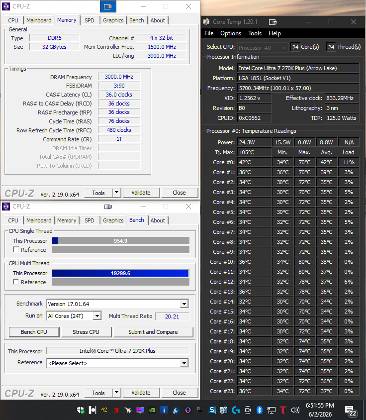

Ok looks like the reasonable limits of this 250K so far, are indeed 5.6 Pcore and 4.9 Ecore.
5.0 Ecore works. but, 5.1 did not. And I don't trust 5.0 for daily driving.
I can't get DDR5 8400 working. Even though it worked fine on the 265K.
Asrock has not updated the BIOS since launch of Arrowlake Refresh. So, maybe they can improve the memory compatibility someday...
(I am also going to re-seat the CPU. I have been trying a Thermal Grizzly Kryosheet (a graphene pad). And it seems like the temps are worse than they should be, with my usual Thermal Grizzly Phasesheet (PTM 7950 copy). So I'm going to switch back to that, and re-seat the CPU in the process. Maybe the memory connection will improve).
Until then, I am running DDR5 8000. And have the latency tweaked to 66ns. Which is right about the best I could get with the 265K.
The 250K should have a little better inherent latency, due to a 100mhz faster base clock for the Ring/cache. And one less cluster for the Pcores. So that's one less 'stop' in the Ring.
As it stands, with the current settings, I am very close to the 265K's stock multicore performance------with two less Pcores and same amount of Ecores. That's pretty dang good.
And while my 265K would do 5.5ghz all day on the Pcores-------it hotter/louder than I would like in gaming. And wouldn't hold 5.5 during cinibench. But this 250K holds 5.6 in cinibench.
I haven't tested gaming yet. I wanna reseat the CPU and switch back to Phasesheet, first.
