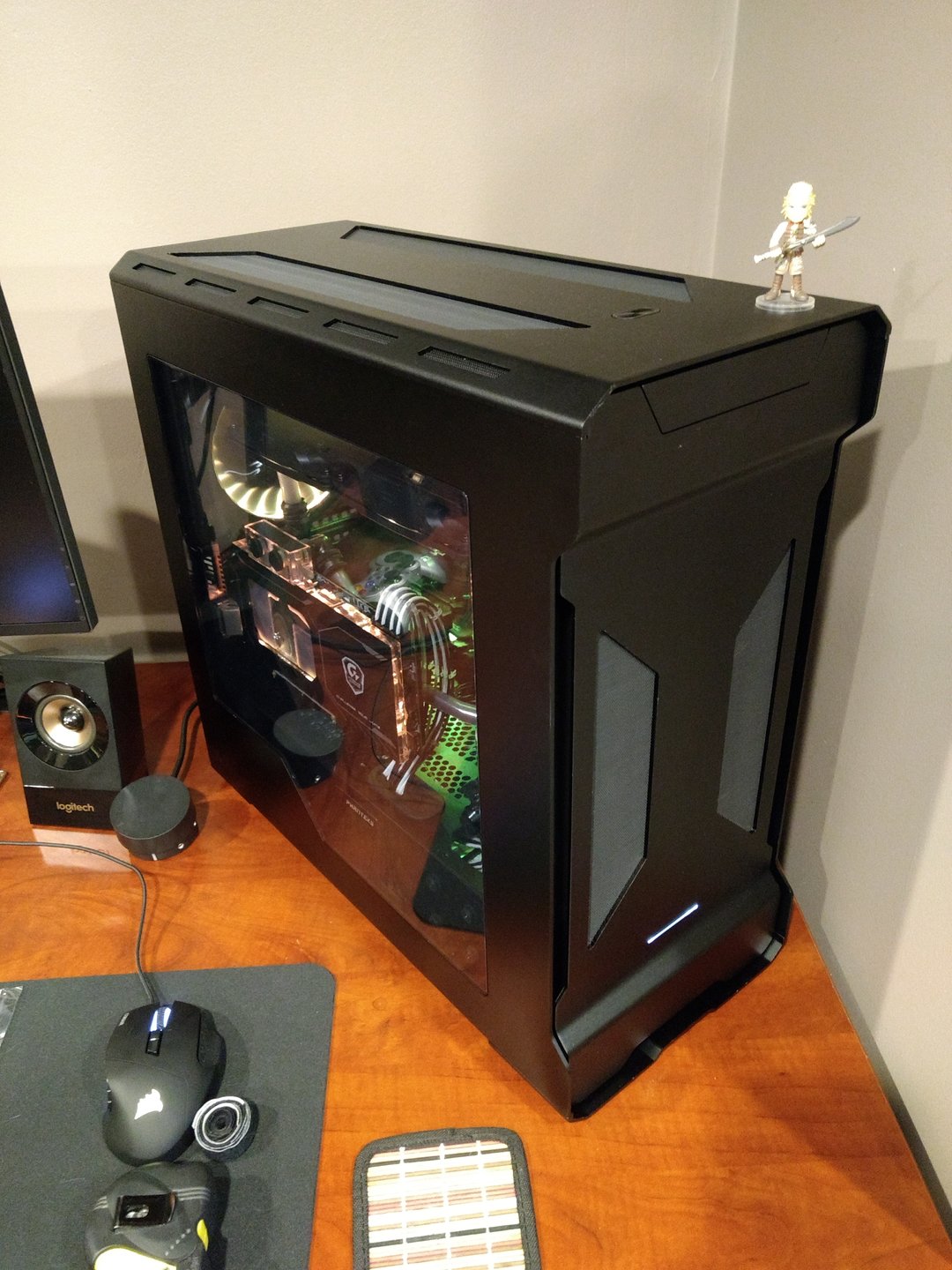

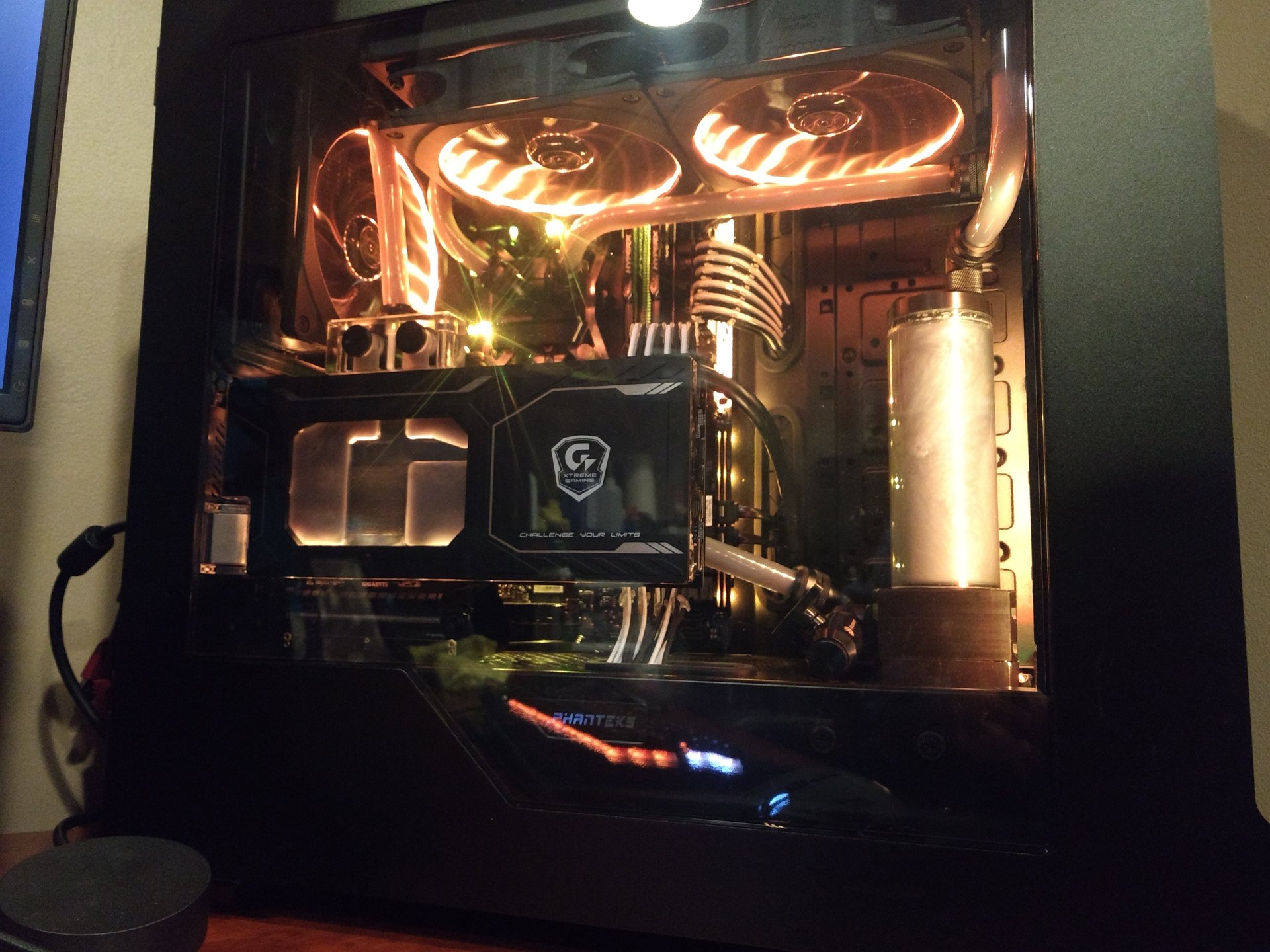

Is that another Phanteks Enthoo Evolv ATX I see there on your desk there?
Gotta share mine! =D

Yeah it's the phanteks evolv,
2*360 Radiators, 1*EK PE, 1*EK SE
Modded so that the fans are in the front and top of the case rather than the main body. Restricts airflow a heap but it works fine. I thought about the vent holes like you've done but have been trying to keep it looking clean. I had great dreams for how it would look but I had an absolute fucking nightmare building it, with literally everything going wrong so in the end I just put it together and thought fuck it, it'll wait for rebuild time.

Oh, I wish I could take credit for those vents. ModMyMods makes them. They're a bit of a wait due to the preorder nature, but well worth it. They really let the Evolv breathe. =)
View attachment 47884 View attachment 47885
