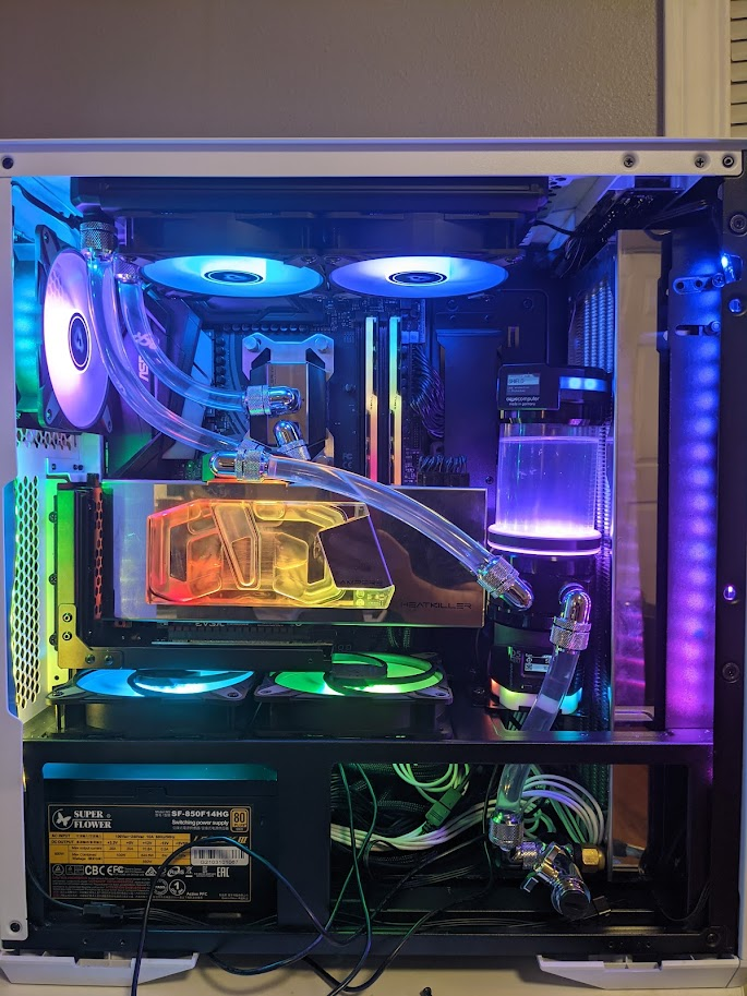

I finally received my Leakshield + Ultitube D5 combo along with new 16/10 fittings and tubing. Since I was there I went ahead and added a drain that I forgot to do the first time (which made draining a real PITA) as well as a veritcal GPU mount because why not.
I did also get the 'fill port' from Aquacomputer which was a bit troublesome to use but it did work with some effort. It was neat to be able to fill the system without having to pour anything in.
It immediately detected a leak during leak testing and I saw the Leakshield in action pulling in vacuum so I could identify the source. After that and another test I was good to go without needing to lay down papertowels! Alarm was a little unnerving though.

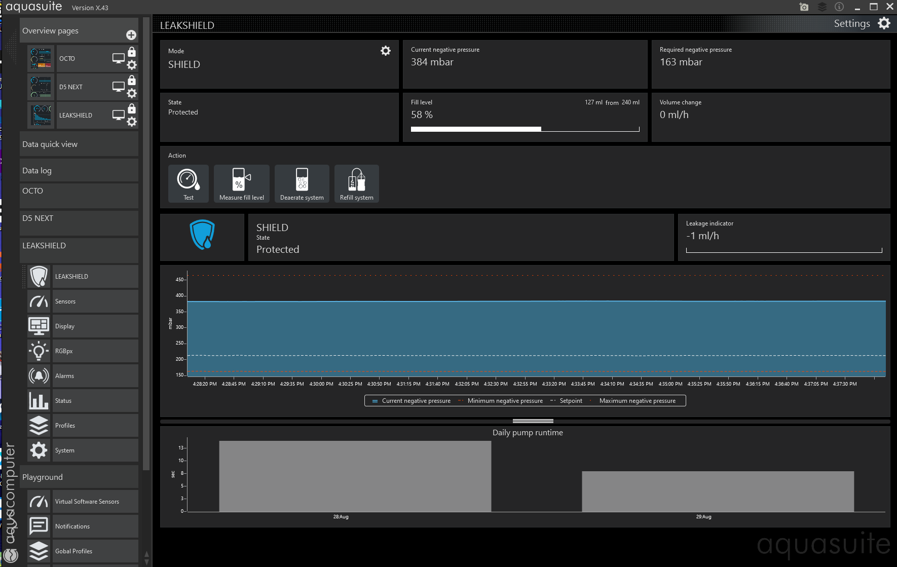

A couple of new screens for the Leakshield and D5 Next in Aquasuite which allows for full control and monitoring. Fill level seems off but I haven't looked too much into it yet.

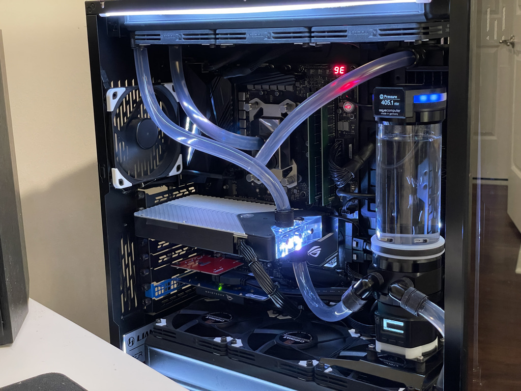

Looks like we've got pretty similar setups.
Definitely enjoy the peace of mind this thing offers. Feel more okay leaving the system on even when I'm not home. Mine also seems to be inaccurate for sensing the level - though I wonder if that represents air bubbles still trapped somewhere in the system. I think the deaeration function would work better if it cycled to the maximum vacuum instead of 300 mbar. Otherwise the thing seems to work great
Mine also is inaccurate reading the level (currently reading at 57%). I haven't really digged into it.
May 7, 2006
687
Yeah mine was reading similarly at the level you see in that picture. I think it's probably some combination of air being stuck somewhere in the loop and the soft tubing collapsing a tad when the vacuum is pulled. It's probably calculating the level based on the assumption that the loop is filled with an incompressible substance and the volume of the "container" (res, tubing, blocks) is constant. With those assumptions, the level can be determined with some fairly simple math. But with soft tubing and trapped air, those assumptions don't necessarily hold true.
Knowing the fill level doesn't seem critical to its function though. If anything, might get some false positives on leaks (which is much better than false negatives).
